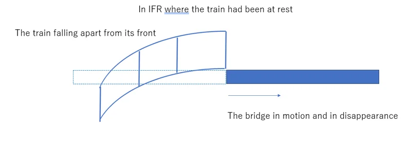

I think the train actually distorts in its original rest frame, rather than tilting. Although it's a funny kind of stress-free distortion that's a relative of length contraction.

...this does not follow. The fall is perpendicular to the direction of motion of the train, so each car of the train still falls the same distance and is damaged by the same amount. The only difference in the train rest frame is that the cars don't hit the bottom all at the same time, since they didn't start falling all at the same time.

Thanks you all for good teachings. I add would add a rough hand drawing explaining the event.

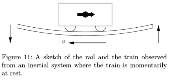

To avoid the complications of gravity, imagine we have the train mounted on Einstein's elevator to simulate gravity.
Then there is a different version of your "paradox". What is the shape of the floor of the elevator. We define it as being flat in some inertial frame, and it remains flat at different times using the clock synchronization of said inertial frame. But if we change our clock syn chronization, the "flat" floor becomes curved, as in the following image, taken from a paper on Thomas precession (an effect on a gyroscope mounted on said frame). Specifically it was taken from https://arxiv.org/abs/0708.2490v1
I once went so far as to derive a metric for the coordinates of this accelerating frame, one that turned into a long thread where other people developed a different metric. I believe both metrics were correct, in the end - If there's some interest I could try and find it, but it was a while ago and wound up being very long and not well organized. My metric had the property (by construction) that the spatial Christoffel symbols vanished, and the floor was curved. Others liked a metric where the floor was still "flat", but in their metric the spatial Christoffel symbols did not vanish.
