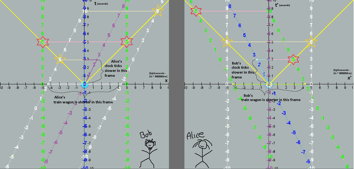

The following picture contains two x-t diagrams, representing how Bob would measure/calculate the events to be happening within his inertial frame of reference in the case of the left diagram and how Alice would measure/calculate the spacetime coordinates within her IFR.
Two side-by-side Minkowski x-t spacetime diagrams with yellow light-beam diagonals, green and blue worldlines, and red star markers; left labelled for Bob, right for Alice, with clock-slowing and train-wagon-shorter annotations.
The two diagrams represent a somewhat more complex scenario.
Think of Bob inside a wagon floating in empty space, with nothing else being nearby. According to special relativity, there is no way for Bob to build a device which could tell him if he is moving or not.
Alice which is also floating in empty space inside another wagon, has no means to tell if she is moving or not as well.
At some point the wagons get closer to each other. Now both Alice and Bob can build devices which could tell them at which speed they are moving relative to each other. In the case of the two diagrams, the speed is half the speed of light. 0.5c
When Alice and Bob meet at some point and are local to each other, they release two yellow laser beams simultaneously to each side of their wagon. Those would be the yellow diagonals in both diagrams, traveling at c ~ 300000km/s.
Since one space unit in both diagrams is 1 lightsecond = 300000km and each time unit in the diagram is 1 second, one can easily see that lightbeams have to be diagonals at a 45° angle within both diagrams.
The blue line in the left diagram is Bob's worldline and the numbers on this line are the clock counts on a watch he is wearing (local to him). Bob considers himself at rest and therefore his worldline is parallel to the t axis and also overlaps with the t-axis since draws the x-t diagram such that he is in the middle of it.
The green lines in the left diagram are the endpoints of his wagon. The numbers on the lines are clock counts of clocks two terrorists are wearing which agreed to trigger two bombs whenever the light signal reaches them simultaneously (at the same t-position within the left x-t diagram). Hence when both their synced clocks display a clock count of 5.
The red stars around the clock count of 5 represent the event of the light beam reaching the two terrorists and them triggering the bomb blast.
In the right diagram, the worldline of Bob and the worldlines of his wagon's endpoints cannot be parallel to the t' axis, because from the perspective of Alice, Bob and the wagon is moving at 0.5c. Hence they are diagonals with their angle depending on the velocity Alice measures for Bob/his wagon.In the right diagram, the purple line is Alice's worldline and the purple numbers are the clock counts of a clock which is local to Alice. The white lines are the endpoints of Alice's wagon and the white numbers are clock counts of two terrorists at the endpoints within Alice's wagon. They will also trigger a bomb when the laser light signals reach them simultaneously. The orange stars representing the event of the blast at t'=5s.
I could take this further now, but since this is a "B" question i just wanted to give you a "picture" of how the events would occur in detail without using too much math.

For example. Let's take the event represented by the right red star(bomb exploding at the right side of Bob's wagon) in the left diagram. That event happens at x=5ls (lightseconds) and t=5s.
The Lorentz transformation formulas to get x' and t' are
##x' = γ(x-vt) ##
##t' = γ(t-(vx/c^2))##
##γ = √(1-v^2/c^2)##
v - the velocity Alice measures for Bob/his wagon
x - the space position Bob measures for an event within his frame
t - the time position Bob measures for an event within his frame
c - the speed of light ~300000km/s
so we get
##x' = 1.1547...(5ls - 0.5c*5s) = 2.88675...ls##
##t' = 1.1547...(5ls - (0.5c * 5ls) / c^2) = 2.88675...s##
So now we know the exact space and time location of where and when Alice will measure one of the bombs inside Bob's wagon triggering, which is x' = 2.88675...ls and t' = 2.88675...s. Something we cannot easily see from just watching the diagram.

Np, just one correction i was too late to edit.
v - the velocity Alice measures for Bob/his wagon should be v - the velocity Bob measures for Alice/her wagon
Since from the diagrams we can see, Bob observes Alice to be moving towards the positive x-axis. Her velocity is therefore 0.5c. (only with 0.5c the calculations would be correct for x' and t')
Alice observes Bob to be moving towards the negative x-axis. She observes him to be moving at v=-0.5c.
The reason for why they don't observe each other to be moving at the same velocities is because of how they chose to draw the x-t diagrams, as in which direction they decided to place the positive and which direction the negative x axis.
We could draw the diagrams in such a way, that both observe each other to be moving at v=-0.5c, or both observe each other to be moving at v=0.5c but i have been told that there is a deeper reason of why it is done this way, you might be able to figure out later.
