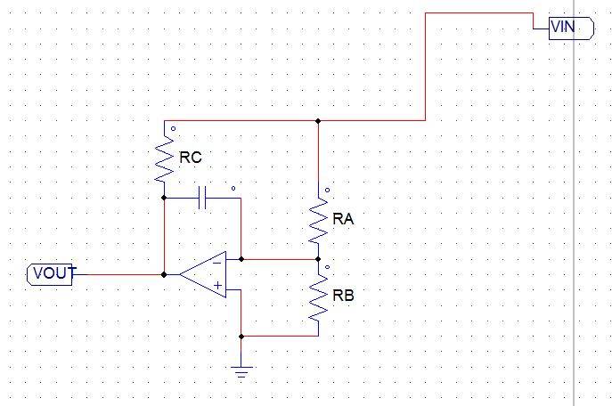

I was wondering if anyone could provide some more insight as to how to find the current through Rc. The first picture TRANSFER1 I can find the current Ic through Rc by the following method:
Ic = (Vin - Vout)/Rc
Vout = -Vin(1/(R*s*C))
Ic = Vin(1+1/(R*s*C))
However, if I add a voltage divider network before the input, the problem becomes much more difficult for me here is my latest attempt:
Ic = (Vin - Vout - I1*R1)/Rc
Vout = (-Vin+I1*R1)/(Ra*s*C)
Ic = Vin + (Vin-I1*R1)/(Ra*s*C) - I1*R1.
Now the problem is that this current will be multiplied by CTR from an optocoupler then multiplied by a pullup resistor to get a voltage Vfb on the other end.
There's no way I can think of to write this equation as Vfb/Vin.
I'm essentially modelling a TL431 and an optocoupler per the following: http://www.onsemi.com/pub_link/Collateral/TND381-D.PDF on page 18I appreciate any help and if this is not the appropriate place to post this, please let me know where I can. I'll keep trying and if I figure it out I'll update this post.
Thanks in advance.

So you're interested in the current through RC.
If we denote ##v_A## as the voltage at the node where 4 resistors join, then you have
##i_{R_C}\ =\ \dfrac{v_A\ -\ v_o}{R_C}##
and this leaves you needing to determine ##v_o## in terms of ##v_A## [easy]
and finally ##v_A## in terms of ##v_{in}## [not too difficult].

The ON Semi TechNote you linked shows that if you have an expression for Ic, Vfb is just Vfb = CTR*Rpullup*Ic. So if you have an expression for Ic such that Ic/Vin = expr, then Vfb/Vin = CTR*Rpullup*expr; this part is easy.
Regarding your result for Ic when R1 and R2 are added to the circuit, wouldn't you expect R2 to be involved in the result? Since your result doesn't include R2 we know right away it's not correct.
Your result so far: Ic = Vin + (Vin-I1*R1)/(Ra*s*C) - I1*R1 includes I1, which you don't know yet.
With R1 and R2 added, the complexity of the circuit has increased enough that it might be time to use a systematic method of solution. It wouldn't be too hard to just write the node equations and solve for the voltage across Rc in terms of two of the node voltages.

Luckily, I had gotten to that point as well, however I am having difficulty with finding Va in therms of Vin. Any way you could point me in the right direction? Modeling that first portion as a voltage divider doesn't seem to work either.
The Electrician said:
You have 4 nodes so you'll need 4 equations for a nodal analysis.
Have you taken into account the effect that the op-amp has on the potentials at its inputs?

☝[/size]Recognize that RA has one end earthed (virtual earth).

Alrighty so after some math, I have the following:
[tex]I_c = -V_in/R_c*(1/(R_a*C*s-x*R_1*R_a*C*s)-1/(1-x*R_1)) where x = -1/(R_a*R_c*C*s)-1/R_c-1/R_a-1/R_2[/tex]

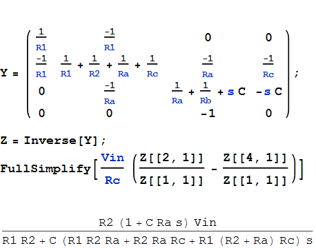

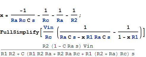

Making the substitution for your auxiliary variable x, I get a reasonably nice looking final expression:
I solved it by doing a full nodal analysis using the 4 nodes:
V1 = Vin
V2 = junction of 4 resistors; also called Va in post #3
V3 = minus input of opamp
V4 = Vout
Then taking the difference V2-V4 (same as Va-Vout) and dividing by Rc, we get an expression for Ic
I get the same thing you got. I actually did this on my HP50g calculator, but to get something I could paste here, I re-did it in Mathematica.

I think your answer might be missing a factor of [tex]R_1[/tex] being multiplied by [tex]R_2*R_A*R_C*C*s[/tex]
I've done and redone the problem using Mathics (like a free mathematica) and keep getting that extra factor of R1 that you don't have.
NEVERMIND I found my error in typing in my values
