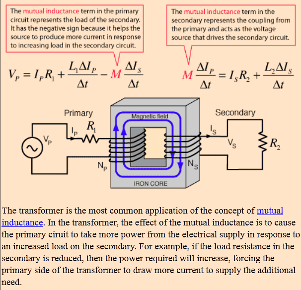

Below is what I've been looking at:

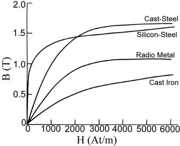

As you approach saturation reluctance falls off. In transformers that requires more current to push flux up to cosine wave's peak, hence that infamous third harmonic distortion.

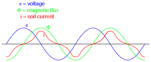

It is useful to slow one's imagination down to near freeze frame pace and think of your sinewave or cosinewave as a sequence of DC stills. After all, at any instant current has only one direction(, and one slope.)
Look at this waveform for sine wave voltage... how hard current must work to push flux up to cosine wave peak.
I can almost hear it grunt.
Were iron linear(constant reluctance) everything would be nice smooth sine&cosine waves.
Transformers operate toward left side of this curve where it's fairly linear.
silicon steel is reasonably straight and requires reasonable mmf up to a little over 1Tesla

It is interesting to put voltage and current traces on an oscilloscope and watch current sprout those peaks as excitation voltage increases.
Try it with a your scope and a doorbell transformer.

Well, i didn't see on those pages their derivation of L for those formulas ...
but another hyperphysics page said this about mutual inductance, which seems to account for the number of turns in their M calc
hyperphysics.phy-astr.gsu.edu/hbase/magnetic/indmut.html= said:
The mutual inductance M can be defined as the proportionalitiy between the emf generated in coil 2 to the change in current in coil 1 which produced it.
So, i agree with your assessment.

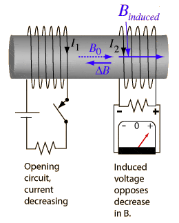

http://hyperphysics.phy-astr.gsu.edu/hbase/magnetic/indmut.html
The induced emf in coil #2 caused by the change in current I1 can be expressed as
You'd have to measure volts on one coil vs di/dt on other.
That's a pretty easy measurement to do with sinewaves and ordinary meters thanks to the derivative relationship for sine/cosine.
For triangle waves i think you'd want a scope.
