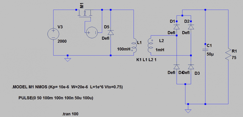

Hi, i was looking for the Energy conversion efficiency of my circuit in Ltspice, but i find out that my Transformers is giving me strange power values i mean with K = 1 the P1 should be equel to P2 but in my case P2 is is way too small , i get equality 90% only if get rid of the Flyback diode, can you please help me understand the reason behind this
why is your file saved as a .asc.dox ?

how should i save it? it is a an asc ltspice file delete the the .dox and you should be able to see it

Can you post a PDF of a screenshot of the circuit and of your analysis?
