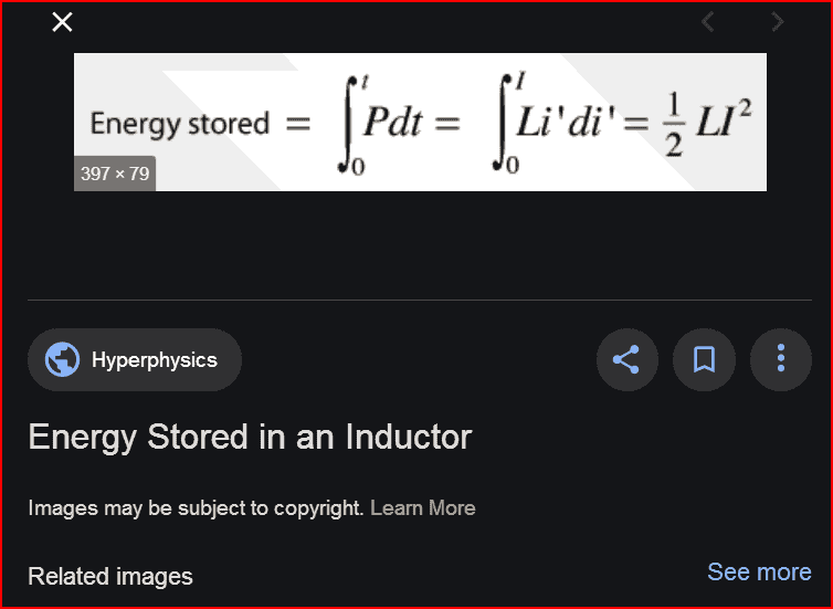

Hello,
First of all I want to say that I am not an EE, I am an ME but I am working for an EE laboratory on campus and am trying to get a force from and electrical circuit on a project here.
I am using the following equations:
F = 1/2*L'*I^2 (where L' = H/m)
and
F = u_0*I_1*I_2*d/(2*pi*r) (where d = length of conductors and r = their separation distance)
I am trying to get the forces acting upon two parallel conductors with opposite current direction. With my hand calculations and simulation in LTspice I am getting a number greater by a factor of 5 with the second equation than with the first.
I have reason to believe the first equation is not valid for what I want but I want to get a second or third opinion.
Thank you ahead of time!

For one thing, the units of the first equation look wrong to me. The RHS has units of energy, not force...
berkeman said:
Can you post links to where you got those two equations?
The equation I am using comes from that equation. The difference is L and L'
The L in the energy equation is inductance (Henry) and the L' in the force equation I am using is inductance/distance (Henry/meter).
So since Work or Energy = Force * Distance, Energy/Distance = Force.
Does this make more sense?
The first equation comes from: http://hyperphysics.phy-astr.gsu.edu/hbase/magnetic/wirfor.html
I think that the problem is a misinterpretation of L'. If we denote the separation distance as s (not the d used by the OP), then L'=dL/ds. This is the result obtained if you apply the principle of Virtual Work to the situation. An ME should especially appreciate this approach (yes, I'm an ME also).

My apologies. I believe L' was not meant to be a derivative, just another variable separate from inductance. View it as a 'distributed inductance' along the conductor. For any length of the conductor, there is a certain inductance per meter. This is what L' is. The separation distance was not involved in this equation, only the other equation.
This notation was not my own doing, it was given to me as such.

So which force is most valid for lateral force between conductors?
In my opinion the first equation it is still possible[except the factor 1/2!].
Instead of ΔL I put "lng" in order to avoid confusion. Then the force formula it is:
F = μo*I1*I2*lng/(2*pi*r) or:
F = μo*I1/(2*pi*r)*I2*lng but:
B(r)=μo*I1/2πr then:
F =B(r)*I2*lng
B(x)=μo*I1/2πx magnetic flux density at distance x from the first conductor center.
Φ(r)=ʃB(x)*lng*dx|x=ro to r] where ro it is conductor radius and r it is distance center-line to
center line.
L(r)=Φ(r)/I1
dL(r)/dr=B(r)*lng/I1 then:
B(r)=dL(r)/dr/lng*I1
and substituting in above formula we get:
F=I2*dL(r)/dr*I1
If L(r)=μo/2π*lng*LN(r/ro) where ro it is the bare conductor radius or:
L(r)=μo/2π*lng*[LN(r)-LN(ro)] then
dL(r)/dr=μo.lng/2πr
F=μo.lng/2πr*I1*I2 the same formula as above.
