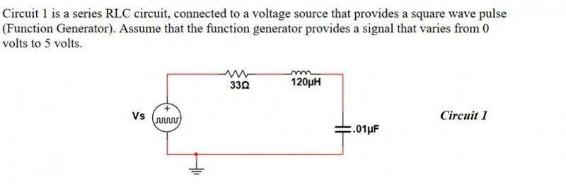

9121. Problem
If we assume that the initial voltage, Vs, is equal to zero, and it rises to five volts at t = 0, derive an expression for the voltage across the capacitor as a function of time. That is, calculate Vc(t)

L= 120 *10^-6 H
C=0.01 *10^-6 F
R= 33 Ω

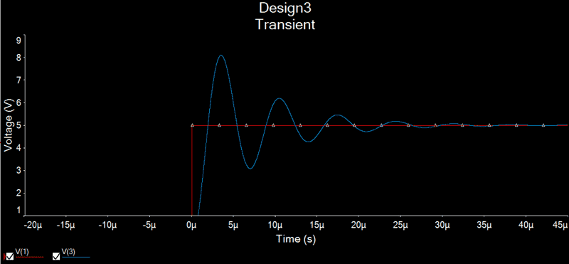

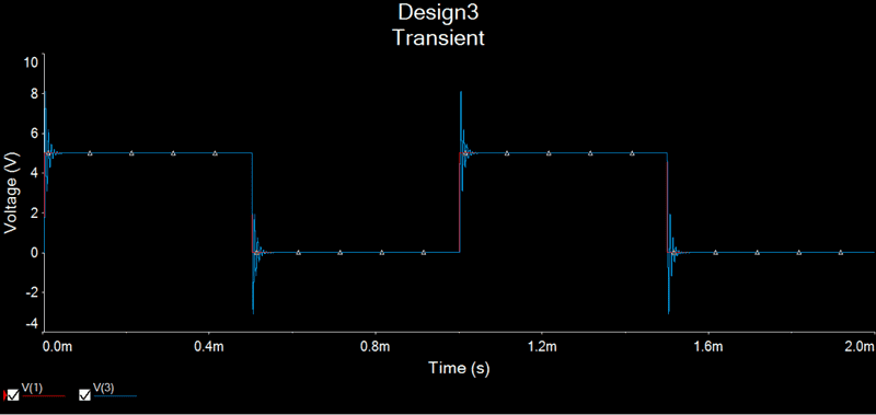

I then simulated the circuit in Multisim with a square wave voltage source of 0 to 5 V.
the transient analysis shows that when the voltage source goes from 0 to 5V the peak voltage at the capacitor goes up to about 8.5V Here is the plot, and a zoom into the first pulse.
The red is the Source voltage and the blue is the capacitor voltage.

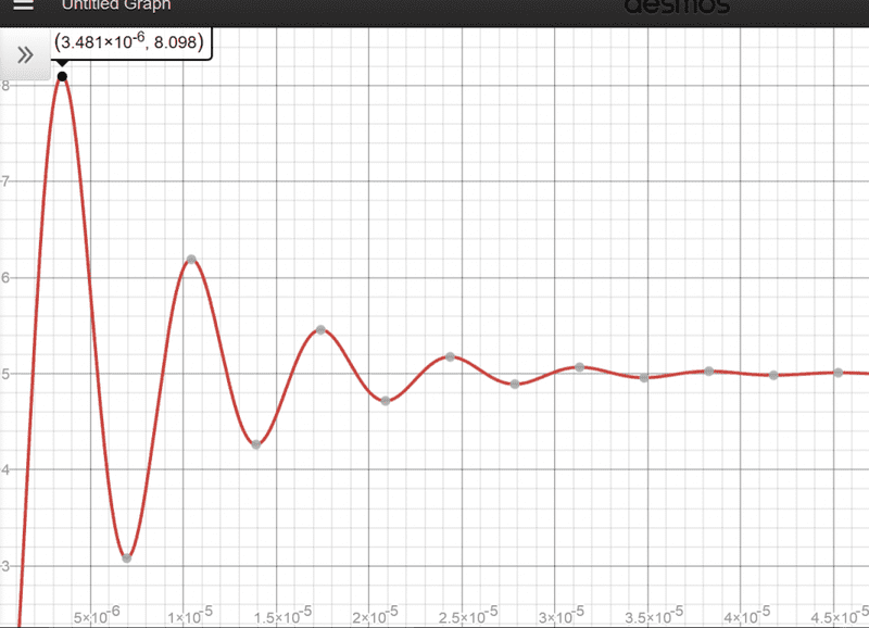

when I plot my Vc(t) it does not resemble this, it gives a lower peak capacitor voltage, Did i mess up in some of the parameters?? Am I missing something?

Your calculated plot looks fine to me. I'd be more dubious abut the Multisim accuracy. Simulators are great tools but you need to be a bit careful with them when dealing with high speed transients. See if you can find a simulator menu where you can specify the maximum simulation time step size and play with the value a bit. See what effect it has on the waveform peaks.
Likes donpacino
Ah yes. I adjusted my time step size and re-simulated now it's pretty much identical to my model. Thanks qneill
