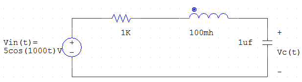

Find the forced response of VC(t)
W=1000
[tex]\frac{d^2V_C(t)}{dt^2}+\frac{R}{L}\frac{dV_C(t)}{dt}+\frac{V_C}{LC}=\frac{Vin}{LC}[/tex]
[tex]V_C(t)=Acos(1000t+\theta)[/tex]

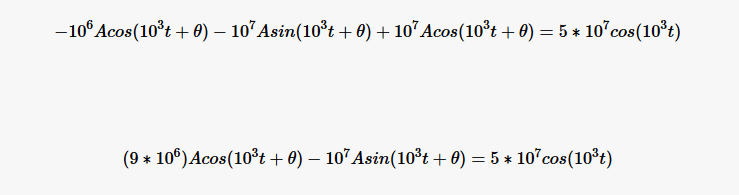

Plug in Vc(t),R,L,C into equation 1
[tex]-10^6Acos(10^3t+\theta)-10^7Asin(10^3t+\theta)+10^7Acos(10^3t+\theta)=5*10^7cos(10^3t)[/tex]
Simplifying:
[tex](9*10^6)Acos(10^3t+\theta)-10^7Asin(10^3t+\theta)=5*10^7cos(10^3t)[/tex]
Trig ID
[tex]\sqrt{(9*10^6)^2+(10^7)^2}*Acos(10^3t+tan^-1(-\frac{9*10^6}{-10^7}))[/tex]
[tex]13.45*10^6Acos(10^3t+41.98°)[/tex]Is everything I've done so far correct? How do I find A?

Is this correct?
[tex]\sqrt{(9*10^6)^2+(10^7)^2}*Acos(10^3t+\theta+tan^-1(-\frac{9*10^6}{-10^7}))=5*10^7cos(10^3t)[/tex]
[tex]13.45*10^6Acos(10^3t+\theta+41.98°)=5*10^7cos(10^3t)[/tex]
I'm not able right now to verify your mathematics, but that is the form that I expect.
So equate the left side cosine magnitude to that on the right side, and solve for A.
Similarly, equate the cosine arguments, and solve for θ.​
One trap to be aware of is that tan–1 can have multiple answers. Your calculator will give you only one, but you always need to consider whether the other/s are applicable to your particular problem.

eehelp150 said:
Can you show the other method?
I used phasors (which uses complex values for impedances) and standard circuit analysis methods. All the usual analysis methods work with phasors (Ohm's law, KVL, KCL, nodal analysis, mesh analysis, etc.), so it's just like solving a circuit with resistors except it uses complex numbers.

I'm thinking that perhaps the issue is with applying the trig identity correctly. The underlying trig identity being invoked is:
##cos(a + b) = cos(a) cos(b) - sin(a) sin(b)##
and we want to associate cos(a) and sin(a) with the coefficients in your equation. Let's start by getting rid of the large exponents in your equation. Dividing through by ##10^7## and letting ##b = (ω t + θ)## for now yields:
##\frac{9}{10} A cos(b) - 1~A sin(b) = 5 cos(ω t)##
Then the 9/10 and 1 are associated with the cos(a) and sin(a) of the trig identity. That means that the angle a is given by:
##a = tan^{-1} \left( \frac{sin(a)}{cos(a)} \right) = tan^{-1} \left( \frac{1}{9/10} \right) = tan^{-1} \left( \frac{10}{9} \right)##
which is the 10/9 that I found by the different approach.
