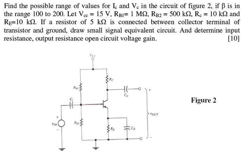

See attachment.
Input resistance is R1||R2
I don't know how to calculate output resistance.
To calculate the base current, I calculated the voltage at the resistor divider (5V), thevinized the base circuit and applied KVL. But Ie is not known.
I am stuck now.

Output resistance is Rc in parallel with hoe.
In the input bias mesh you have the Thévénin equivalent of Vcc, Rb1 and Rb2 in series with the base-emitter diode. You can calculate IB. From IB and beta you can calculate Ic.
CEL, so its basically (Vb-0.7)/Rth
where, Vb is the voltage at base; Rth is the thevinin equivalent and 0.7 is base-emitter diode drop.
Correct?

Correct.
There is a voltage across the emitter resistor caused by a base current and a collector current 100 times as great as the base current.
Have you allowed for this?

yup.
Are you sure?
The emitter voltage depends on the base current you are trying to calculate, but multiplied by 100.
The voltage drop across the emitter resistor is Ie*Re.
Ie is almost equal to Ic
Ic = beta*Ib
Is this what you are talking about?
Yes, but you don't know Ib, so how can you know Ic or Ve?
Well, Ib is Voltage divider voltage(5v) -Vbe drop(0.7v)/Thevinin equivalent of the 2 resistors - Rb1 and Rb2.
Ib= (5v-0.7v)/Rth
I then calculate Ic, which is beta*Ib

No, Ib is Voltage divider voltage(5v) -Vbe drop(0.7v)/Thevinin equivalent of the 2 resistors - Rb1 and Rb2 - voltage across Re (beta+1)Ib.
You have an equation with one unknoen: Ib.

That's what I initially thought, but to find the current thru a resistor
I = V/R
[STRIKE]The voltage across Rth is (5-0.7)v
That divided by Rth should give I flowing thru Rth, which is nothing but base current.
Correct?[/STRIKE]
(just realized)
Dang! I get it. The voltage at right side of Rth is not 0.7v, it is 0.7+drop across Re.
Thanks.
Yes. That is much better.
