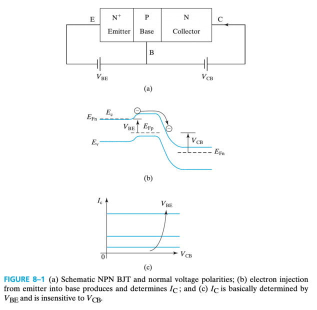

You definitely seem curious about the topic but I think you have quite a lot of misunderstandings. I can highly recommend Chenming Hu's (TSMC Distinguished Professor Emeritus and 2020 IEEE Medal of Honor winner) Semiconductor Textbook, which should also qualify as a physics textbook. It was written with the practitioner in mind so it might be more up your alley than the more conventional physics textbooks.
I think there are many sections of it you would find interesting but I'll point out this particular section of chapter 8 as it seems to be on topic.
https://www.chu.berkeley.edu/modern...-integrated-circuits-chenming-calvin-hu-2010/
"Figure 8–1b shows that when the base–emitter junction is forward biased, electrons are injected into the more lightly doped base. They diffuse across the base to the reverse-biased base–collector junction (edge of the depletion layer) and get swept into the collector. This produces a collector current, IC. IC is independent of VCB as long as VCB is a reverse bias (or a small forward bias, as explained in Section 8.6). Rather, IC is determined by the rate of electron injection from the emitter into the base, i.e., determined by VBE. You may recall from the PN diode theory that the rate of injection is proportional to e^(qVBE ⁄ kT) . These facts are obvious in Fig. 8–1c."
Ic is NOT "determined" by Vbe. Ic changes as a result of Ie changing. Vbe catches up eventually.

You’re wielding Shockley’s equation like it’s an axiom but it’s not. It’s a solution to a very particular system known as a BJT. But, where did Shockley derive it from? And what experimental evidence supports those equations? And what do they have to say about this topic? I would write it down but Dr. Hu has done an excellent job for me and I doubt I can improve upon his work. In addition Berkeley has made his work available for free! I suggest you take advantage of it.
Edit: I also just remembered Sedra & Smith has a pretty decent derivation of the Shockley equation (and MOSFET and PN junction for that matter) just using dimensional analysis which might be more approachable. It's definitely not free but it's been a standard microelectronics text for decades so I think most libraries, pretty much anywhere in the world, should be able to obtain it. The problem is that derivation will only work for a 1d transistor, basically one line in the cross section. But it illustrates the point nicely and succinctly.

You're loosing me in this argument.
I thought you were trying to prove Ic is not determined by Vbe. I can't understand how the simulation of a diode, or the measurement of a diode in lab, shows that when a diode has no collector.
If BE in a transistor is just a diode what is the explanation for the current gain in the collector? If the answer is the transistor action equation given, where does alpha come from? Is alpha a parameter that can be manipulated by the designer of the BJT? How do they do it?
As a side note, I think you'll also notice the diffusion constant of the base is a member of the Ies constant given in the equation for Ic, why is that there?
Seriously. Read Dr. Hu's book. I think you'll get a lot from it.

Is the geometry of the collector region not important? It doesn't seem to factor into the explanation.
Notice the structure on slide 3. (Jaeger's Microelectronics is also a great text for this) Given your explanation, what is the n+ buried layer for? (you might also notice the emitter volume is shown as smaller for this particular device)
https://engineering.purdue.edu/~ee255d3/files/MCD4thEdChap05_[Compatibility_Mode].pdf
In any case, the equation for beta has two other very important components besides doping. The width of the base and emitter depletion region as well as the diffusion constants. See equation 5.3.11 from the link below. How do those factor into the explanation?
https://ecee.colorado.edu/~bart/book/book/chapter5/ch5_3.htm#5_3_1
Have you ever see a figure like 5.3.1? (link below) Since your claim is Ic is not determined by Vbe how do you account the distance wb-xp,bc? Is that distance not a function of Vbe?
https://ecee.colorado.edu/~bart/book/book/chapter5/ch5_3.htm#fig5_3_1
