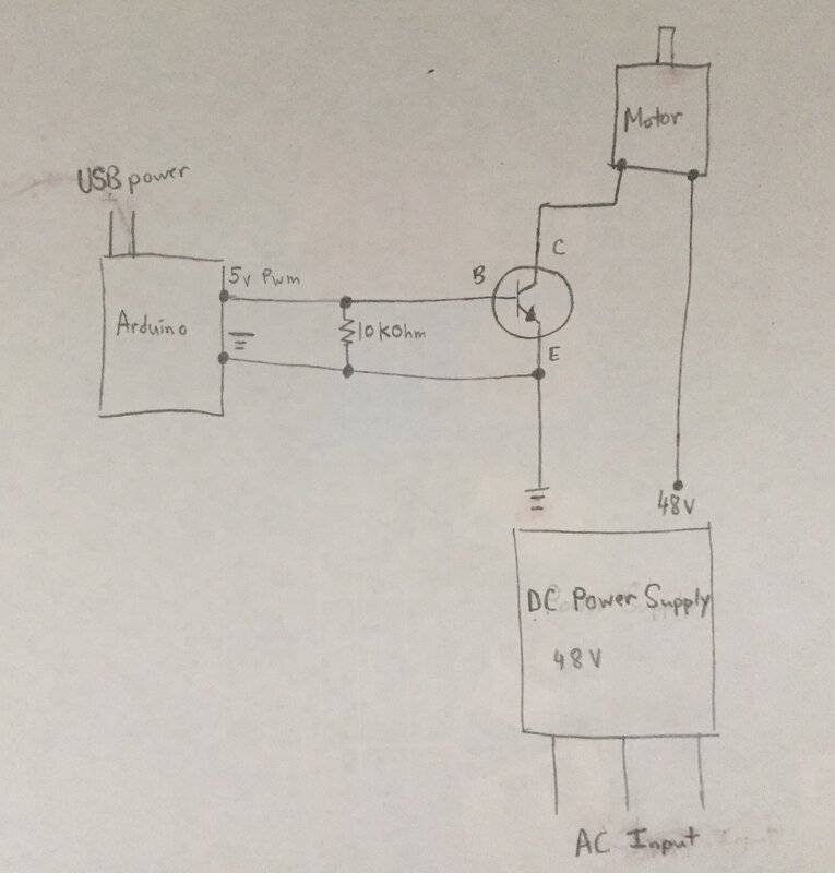

Hey guys, here is my circuit.
You have drawn an NPN BJT, with E,B,C, not an N-channel MOSFET with S,G,D.
Are you certain that the Arduino output is going to 5V ?, might it be only 3V ?
The 10k pull-down resistor makes it harder for the Arduino pin to go high. That resistor is not needed if you can quickly initialise the port to output and low.
A motor is inductive. You should connect a reversed power diode across the motor to catch the positive flyback voltage spike that could kill the MOSFET. That damage may have happened earlier and could explain your resistance readings.

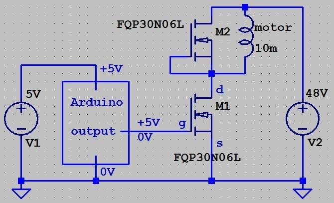

Here is an example circuit with MOSFET and flyback diode.

Ah interesting, okay that gives me a lot to work with.
My question is if the transistor could handle the initial current wouldn't it be able to handle the flyback voltage spike as well?
Also what specs should the reversed power diode have? I found a bunch of them on eBay but am having a hard time choosing the right one.

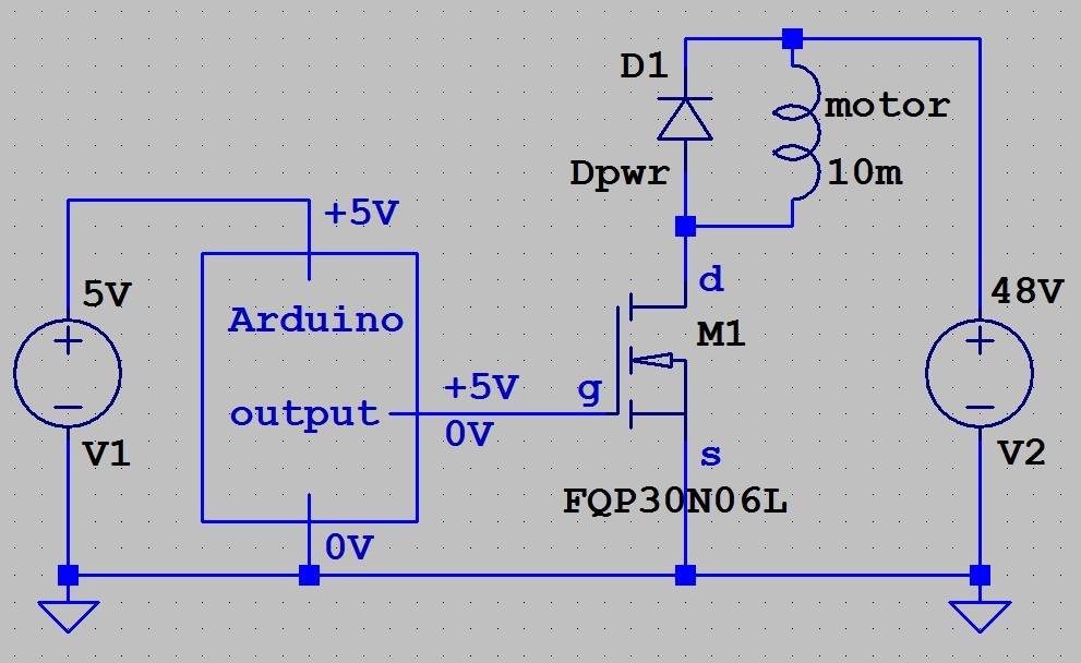

The flyback diode needs to be a fast recovery diode, rated to carry the motor current.
An experimenter can sometimes cheat and use another cheap MOSFET with a good body diode specification. That is the equivalent of a half bridge circuit, but without the high-side control.
Here is an example;

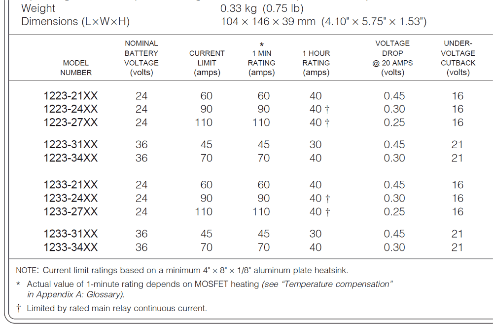

Curtis Instruments make a range of controllers including the 1223 model for my wife's heavy duty off road mobility scooter. The 1223/1233 range goes from 24 to 36V, with current limited from 45 to 110 Amps, and with a 1 hour rating of 30 to 40 Amps.
The output circuit is multiple power MOSFETs in parallel with a copper bus necked at each MOSFET to balance the currents. I could dig out the part number if required.
It is fully programmable, has soft start and stop and full four quadrant operation. There are comprehensive manuals on the web site.
RS Components is a good UK source of components and controllers. Their United Automation, DC Motor Controller is PWM, input voltage 6 - 24 V dc, current 40 A max. It is £33.
