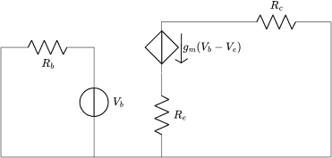

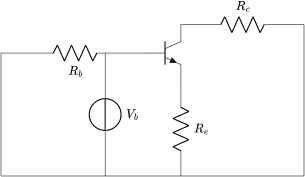

If base-to-collector voltage gain is negative, base-to-emitter voltage gain is positive, should emitter-to-collector voltage gain negative as a result of multiplying base-to-collector gain by the inverse of base-to-emitter gain? How come emitter-to-collector gain is positive?
For a simple bipolar transistor above, base-to-collector voltage gain ≈ -gm*Rc/(1+gm*Re) < 0, base-to-emitter voltage gain ≈ 1 > 0, should emitter-to-collector voltage gain ≈ -gm*Rc/(1+gm*Re) * 1 < 0. How come it is equal to gm*Rc > 0?

I think I know why. Compute this way would only give indirect gain from emitter to collector.
Why are we multiplying the two gain figures? The output voltages are in series, so if being referenced to ground they are subtracted to obtain the signal voltage between the collector and emitter.

I guess a better way to rephrase my question is why base-to-collector voltage gain(common emitter) vc/vb does not equal to emitter-to-collector voltage gain(common base) vc/ve multiplied by base-to-emitter voltage gain(emitter follower) ve/vb?
I believe it is related to inspection analysis limitations for circuit with feedback.
The voltage gain of transistor circuits is determined by more than just the transistor. Resistors in the circuit have a lot to do with the voltage gain.
This gain formula for a common-emitter gain stage with negative Re-feedback is correct - however, only in case the signal source is connected DIRECTLY to the base node (via a coupling capacitor).
When there is a resistor Rb (as in your drawing) this resistor forms a voltage divider Rb-r_in and the gain will be correspondingly lower (r_in=dynamic signal input resistance at the base node).
Just for your understanding; "Negative gain" means nothing else than a phase inversion (180deg phase shift) between the signal voltage at the base node and the output voltage at the collector.

Yes. I find these circuits much simpler to understand and solve if, at the device level, you think in terms of currents, not voltages. Of course voltages make currents and vice-versa.
Most of your questions can be clarified if you redraw your circuit using the basic T model of a BJT shown here.
Some like to move the small signal emitter resistor ##r_e## to the base, where its value becomes ##(\beta + 1) r_e##. Although you'll often see ##\beta r_e##, since ##\beta + 1 \approx \beta## for high gain devices.
To quickly identify the BJT polarity in the circuit, draw the symbolic arrow head on the emitter. Also, identify the polarity of Vs.

In the original figure there are many voltage sources with only labels so below I have attached the same figure with voltage sources added.
At this point it's nice to notice two things:
1) there are 2 total voltage sources and none are at the base, emitter or collector. So, finding the "voltage gain from ##a## to ##b##" will mean that I must turn off all sources that I am not interested in and add a voltage source at ##a## and solve for the voltage at ##b##.
2) I am looking for the linearized transfer, so while there are many ways to model a BJT; the simplest for our case is to say: ##I_{ce}=g_m(V_b-V_e)##
So, lets answer the questions:
1. Solving the voltage gain from the base to emitter with all sources off I add a voltage source at ##V_b## which becomes:
##V_e=R_eg_m(V_b-V_e)##
Solving for ##V_e## I get:
##\left.\frac{V_e}{V_b}\right|_{V_{in}=0,V_{s}=0}=\frac{R_eg_m}{1+R_eg_m}##
Here I directly state ##V_{in}## and ##V_s## must be off.
This result can be further simplified by claiming ##R_eg_m\ggg 1## then I have your result ##\left.\frac{V_e}{V_b}\right|_{V_{in}=0,V_s=0} \approx 1 ##
2. Solving the voltage gain from the base to collecter becomes:
##V_c=I_cR_c=(-g_m(V_b-V_e))R_c##
I know ##V_e## in terms of ##V_b## from above so:
##V_c=(-g_m(V_b-V_e))R_c=(-g_m(1-\frac{R_eg_m}{1+R_eg_m}))R_cV_b##
##\left.\frac{V_c}{V_b}\right|_{V_{in}=0,V_s=0}=\frac{-g_mR_c}{1+R_eg_m}##
3. Solving the Voltage gain from the emitter to the collecter I have to place a voltage source at the emitter and get the following:
##V_c=R_cI_c=R_c(-g_m(V_b-V_e))##
Notice that the dependent current source depends on V_b so it must be a known quantity, I set it to zero ##V_b=0## so I get:
##\left.\frac{V_c}{V_e}\right|_{V_{in}=0,V_s=0,V_b=0}=R_cg_m##
Finally, the last question: to find the emitter to collector gain I have to have a known base voltage; the base to emitter and base to collector transfers assume the base voltage can be anything, where the emitter to collector assumes that it must be constant, so strictly speaking they are not the same, ie:
##\left.\frac{V_c}{V_e}\right|_{V_{in}=0,V_s=0} \neq \left.\frac{V_c}{V_e}\right|_{V_{in}=0,V_s=0,V_b=0}##
