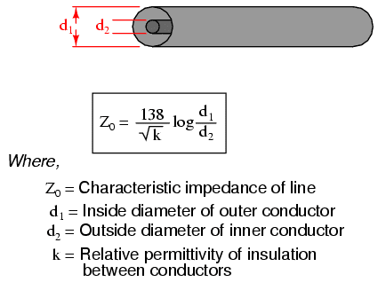

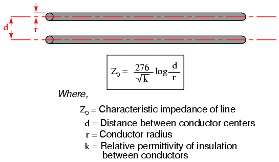

all coax or parallel line cable I can buy has a fixed impedance regardless of freq otherwise it would be uselesssome reading up on the subject would be a good idea for you :smile:
https://en.wikipedia.org/wiki/Characteristic_impedance
https://en.wikipedia.org/wiki/Transmission_linesome basics ...
a twin parallel line ...
a coax cable ...
you will have noticed that length and voltage and frequency didn't factor into the equationsDave

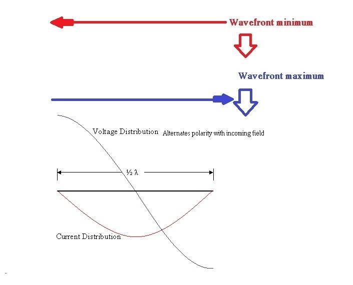

The first step toward understanding transmission lines it to appreciate the concept of resonance in a straight piece of wire.
Thought Experiment in two steps:
1. Imagine in space an electromagnetic field that is alternating at high frequency. Let us use for our example the field produced by radio station WLS of Chicago , which is 890 khz. I used to get that station on my car radio in Miami on clear winter nights so i know it's a real field.
Its wavelength would be c/890,000 = 337 meters.
2. Now add to your mental picture a lone wire one half wavelength long, 168.5 meters, oriented so the electromagnetic waves encounter it crosswise.
Observe that as a wave encounters the wire it begins pushing charge toward one end and away from the other end.
At the center of the wire charge flows along freely filling one end, and emptying the other.
At the ends of the wire charge cannot exit so accumulates there.
As the electromagnetic wave passes the wire and reverses its polarity, current in the wire reverses . The ends acquire charge of opposite polarity and current in the middle reverses direction.
Aha ! that's an AC voltage peak at each end and a current peak in the middle.
When your wire is a half wave long its inherent capacitance to rest of the universe and its inherent self inductance make it resonant, just another quirk of the universe. Resonance implies more current and voltage than you'd expect, and indeed that's what you get.
That's the principle behind TV "Rabbit Ear" antennas with adjustable length 'ears' - a straight wire that's resonant . They take current from the middle and feed it into the TV tuner. Since we're dealing with microwatts impedance matching becomes important.
A transmission line is two wires in proximity so there's mutual inductance and capacitance between them. That changes things from the free space example just described but not fundamentally. Just instead of permittivity and permeability of free space we use the properties of whatever is in between the wires. That just changes velocity of propagation down the line, instead of c it's a property of the line about 2/3 c for most everyday cables.
And, since current can flow out the end of the transmission line into a load, one can flatten out his standing waves by attention to impedance matching.. That's the "Reflection coefficient" in those equations.
