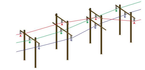

Ideally, all phases in a 3 phase network should be equal and balanced. Balanced in load, and balanced in impedance.
Since the locations of the 3 conductors on the pole are not a perfect triangle, the impedances are not exactly balanced. Transposing the conductors once in a while tries to cancel that so that the end-to-end impedance really is balanced.

Not the resistance, but the reactance is what is significant. There are two sources, mutual inductive reactance between the lines, and capacitive reactance between each line and ground.
Marcin H said:
And why would a NOT perfect triangle make the impedances not balanced? Is it because the wires could have different amounts of flux linkage or coupling? I feel like I'm also getting a bit confused in the terminology here.
Because not all corners of the triangle can be the same height above the ground.
Marcin H said:
Also, what does once in a while mean? How often do we have to transpose our wires on a transmission line of length d or something?
There's no set formula. Transpose once every 50 to 100 miles is what I'm used to. The loads are also slightly unbalanced, so there the balance of the transmission line needs to be good, not perfect.
For the benefit of those who don't know what we're talking about, this is a transpose.
Diagram of a three-phase power line transposition: three conductors labelled A, B and C swap positions across successive poles, shown as red, green and blue lines.

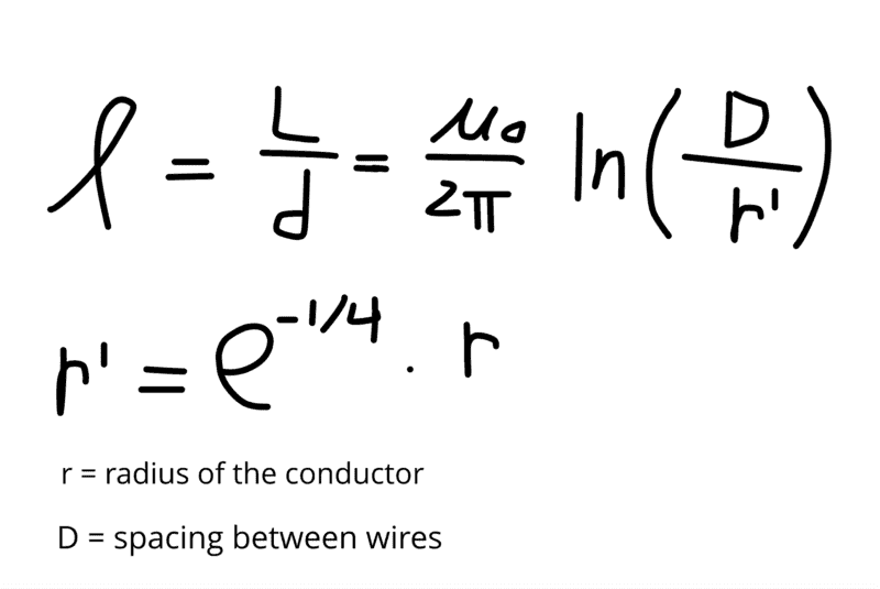

Thank you for the lengthy response. This actually cleared up a lot. I think after a few more classes and examples I will have a much better understanding of this. Could you explain what geometric mean distance (GMD) is exactly and how it's used? Is it only used if the distance between our wires is different? For example if we don't have a perfect equilateral triangle or if we don't have an equally spaced horizontal transmission line?
Also, do you have a good source for derivations or proofs for varies transmission line orientations? I have the equations in my notes with a proof using superposition, but I had a hard time follwoing that proof. Specifically I had a hard time understanding where the (D/r') come from in the formula for each wire when superposed and the sign they get. Some wires had a negative sign but I wasn't sure where it came from.
The formula I am talking about is per unit length inductance of a wire:
Handwritten derivation of per-unit-length inductance: l = L/d = (mu_0 / 2pi) ln(D/r'), with r' = e^(-1/4) * r, where r is the conductor radius and D is the spacing between wires.
Edit*** that equation was for the case of a 2 conductor line. Before that we found the per unit length inductance at a distance R on some long flat sheet, so that D in the equation above would be an R. I didn't fully understand that derivation either. I have R labeled as the distance between the wire and it's return path. Which reminds me... Is the return path just the neutral wire? Do we always have a neutral wire on a transmission line?
