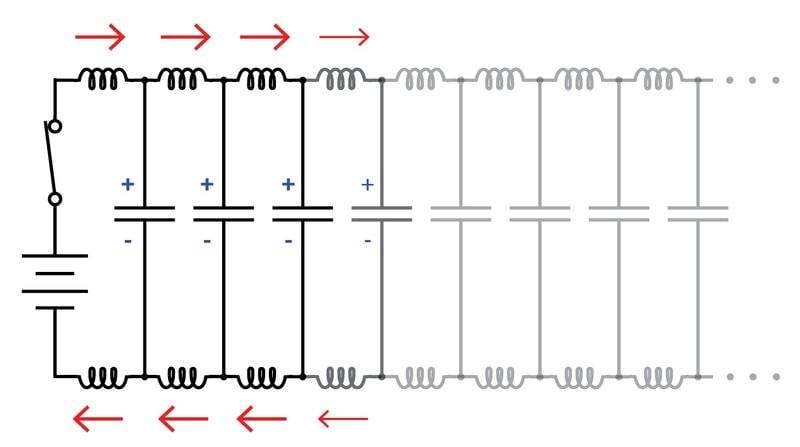

If the parasitic capacitor needs to be charged up one by one along the transmission line in order for voltage to propagate, then how can current be so much slower than propagation?
I am a bit confused on the speed of voltage propagation in the transmission line and I hope someone can enlighten me. I understand the speed of voltage propagation is in the same order as the speed of light and it is much faster than current. But if we can model the transmission line with a distributed LC model as the image attached, how can the modelled capacitors got charged so fast at a rate proportional to the speed of voltage propagation if an electron travel much slower? In other words, voltage propagation requires capacitor to be charged up one after another along the transmission line according to the model. If this is the case, that means electrons need to travelling from the + side to the - side in order to charge a capacitor but if electron is indeed traveling very slowly then how can voltage propagate that fast in the transmission line?
Image source: https://www.allaboutcircuits.com/textbook/alternating-current/chpt-14/characteristic-impedance/
Say what? The voltage does not propagate by magic. It takes the current to change the voltage on the distributed capacitance(s).

eyeweyew said:
But charging capacitors requires electrons to move from + side to the - side through the wire/transmission line but the drift velocity of electron is slow so charging up capacitor should also be slow.
Not so. The current does not flow through the capacitor, but separately builds up an equal and opposite charge alternately on the electrode surfaces.
As the EM wave propagates along a two conductor line, the cloud of free electrons in the conductor move along the line. What happens in one conductor is reversed in the other conductor.
To understand the capacitive effect of the line, think of the electrons sloshing backwards and forwards locally in the line as the voltage wave propagates. Where it becomes negatively charged, electrons pile up, where it becomes positively charged, electrons move away from. That provides the virtual capacitor voltage.
The inductive effect comes about because the magnetic field propagating along the line induces equal and opposite currents in the conductors. That current, in each conductor, produces an equal and opposite magnetic field that reflects the magnetic field from the conductor. The current that flows matches the voltage on the capacitance of the line, and keeps the EM energy and fields in the line.
The characteristic impedance of the line is the ratio of voltage to current, and also the ratio of the E field to the M field. All those are locked in phase by local electron movement as the EM wave propagate energy along the line.

eyeweyew said:
But charging capacitors requires electrons to move from + side to the - side through the wire/transmission line but the drift velocity of electron is slow so charging up capacitor should also be slow. If that’s the case, how can the propagation speed of a step increase in voltage along the transmission line be so fast?
Ditch the transmission line theory and think of a simple RC network. Same thing. The capacitor can be made to charge up much faster than drift velocity.

So if I understand this correctly, I can summarize this as: At any point on the transmission line, the local capacitor will get charged by local charges nearby and a local current will start as the EM wave(generated by the sudden change in voltage) arrives from the voltage source.

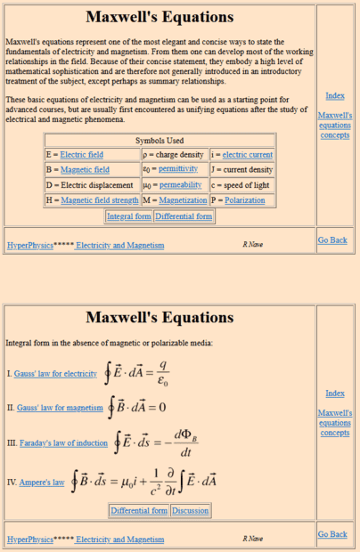

Have you learned about Maxwell's Equations yet for the propagation of EM? That would be a much better subject for you to spend time studying, IMO...
http://hyperphysics.phy-astr.gsu.edu/hbase/electric/maxeq.html

It is important to realise that the EM field in the dielectric insulation of the line causes the local electrons to move and change density. That movement of electrons is the current that guides and supports the magnetic field, while the electron density changes the voltage on the line, which guides and supports the electric field.
The EM field propagate at close to the speed of light, causing the differential electron density wave to move at that same speed along the line.

Thanks! The picture explains a lot, at least for AC input. If the input is a sudden step change in voltage by closing the switch without opening it again, the voltage source needs to spit out electrons to one line and pull back electrons from the other line to maintain the density behind the wave.
