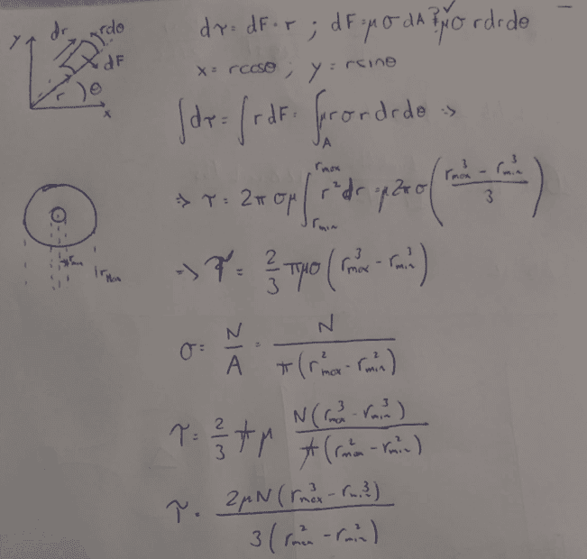

I want to derive the formula for the transmission of torque through friction.
I am trying to obtain the expression for the potential transmission of torque using friction.
I could derive the formula assuming constant pressure between planar surfaces.
Handwritten derivation of frictional torque on an annular disk: dF = μ dA, dτ = r dF, integrated from rmin to rmax to give τ = 2πμσ(rmax³ − rmin³)/3 and τ = 2μN(rmax³ − rmin³)/(3(rmax² − rmin²)), with a small sketch of an annulus and a shaded area element.
To have it in LATEX so it is easier to read, this is the expression for the torque transmission using friction.
$$\tau=\frac{2\mu N(r_M^3-r_m^3)}{3(r_M^2-r_m^2)}$$
This is the same as what I later found in this video of Youtube so I'm fairly confident that the result is correct.
(Note: He is using ##F## instead of ##N## for the normal force and also his disks are solid without a hole in the middle)

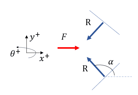

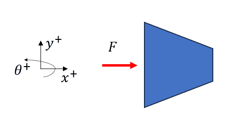

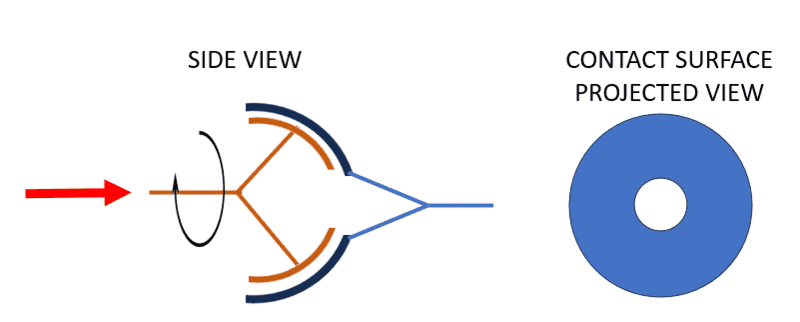

I'm now interested in knowing a similar but a little bit more complex case. Spherical contact instead of planar contact. Not necessarily half a sphere but that would be the case with the biggest contact patch.
Side view diagram of a cone-like clutch: a red arrow pushes a central shaft with a curved black rotation arrow, and orange and blue conical parts with dark navy curved backing pressing together. Right panel shows a blue annulus labelled r, a projected contact surface view.
In this scenario, assuming a constant pressure makes less sense. As the contact patch becomes more tangential to the force, I assume the normal force between surfaces will decrease. How would you obtain the normal pressure between surfaces as a function of the angular position under study? Because of the rotational symmetry, I believe it'd be possible to express that function as ##\theta (r)## (see the diagram of the projected area) but I don't know how. Once that normal pressure is known, I hope to be able to derive the torque in a similar way as I did for the planar case.
  • Diagram with a side view showing a red arrow pushing toward a conical shaft with a curved orange and navy contact surface, and a contact surface projected view showing a blue annulus with a central hole.

With the spherical case, I assume the shafts remain coaxial, or you will have a friction drive with a Cos(theta) speed reduction ratio.
There are two ways of applying force to the spherical contact surface.
1. As a spherical radial force, the outer sphere is shrunk onto the inner, or the inner expanded against the outer. That is a different problem, related to the elasticity of the material.
2. As an axial force. Reduce the problem to axial and radial components. Think of the contact surfaces as having small dx and dr orthogonal steps. Since the force is axial, the pressure is axial. The radial component of force does not exist, so radial pressure need not be considered. The radius of the sphere then becomes equivalent to the radius of the flat disc, with the same torque equation.
If the spheres were elastically deformed by the force, the problem would become more complex, and begin to approach case 1, or a drum brake.

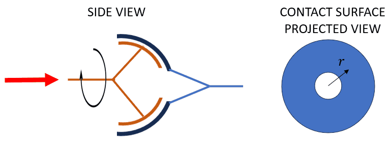

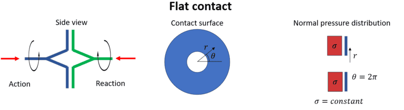

For the flat contact, I believe it's clear but I'll add this diagram because it's a good foundation for the spherical case.
Diagram titled Flat contact with three panels: a side view of two coaxial shafts pressed together with opposing red axial arrows labelled Action and Reaction, a blue annular contact surface with radius r and angle theta, and a normal pressure distribution sketch showing sigma, r and theta = 2 pi with sigma = constant.
Assuming a constant pressure distribution I can then do the integral shown in #1 to find the torque.

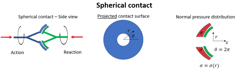

For the spherical case though I can't obtain the function ##\sigma (r)##.
Three-panel diagram titled Spherical contact: side view of two spherical contact surfaces with opposing red force arrows labelled Action and Reaction; a blue projected contact annulus with radius r and angle theta; and a normal pressure distribution sketch with sigma and sigma, theta = 2pi, and sigma = sigma(r).
I know that the integral of the horizontal component of ## \sigma## must be the axial force but that's it. I don't know the function itself. And even if I had it I believe I cannot integrate in the projected surface to follow a procedure similar to the one used for the flat surfaces because near the shaft there'll be a greater concentration of surface.
These complications are why I wanted to confirm if the flat case can be considered a conservative scenario. I believe it'd produce greater friction as mentioned in post #2.
Just because the total force is only axial, doesn't mean there are no radial forces, which cancel each other, but still affect the pressure distribution.

I think the effect of the changed pressure distribution, is cancelled by the increased surface area of the sphere, compared to the disc.
Without elastic deformation, or wear, I cannot see how the friction or torque can be different between the disc and the sphere. I believe that force is important, that pressure is a distraction, and you are chasing your tail.

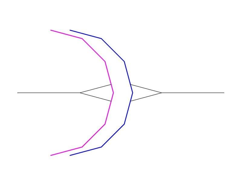

Could you try calculating several conical sections approaching the spherical shape instead?
It seems to me that as the sectional cones tend to the shape of a cylinder, a wedge self-clocking self-locking effect should appear, making the disengage process and a smooth engaging difficult.

It seems to me that as the sectional cones tend to the shape of a cylinder, a wedge self-clocking effect should appear, making the disengage process and a smooth engaging difficult.
Self-clocking, or self-locking?
Self-locking requires that one cone is able to move axially. That is not the case with an in-elastic sphere, since the almost-flat front-face prevents further movement once it contacts. That is why the analysis of the inelastic sphere, with only axial force, collapses to that of the disc.

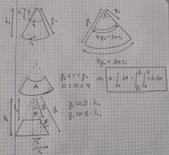

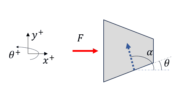

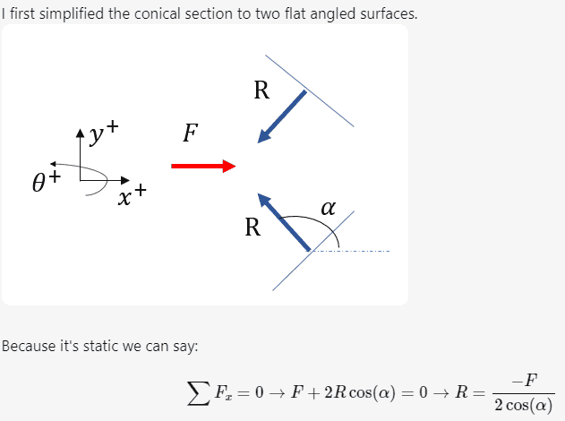

I didn't think about discretizing the problem like that. It could be a valid approach if I can't find the actual pressure distribution on the spherical case.
I'd first need to derive the friction on a conical section with an arbitrary angle. I'll give it a shot and return to confirm if the results are correct.

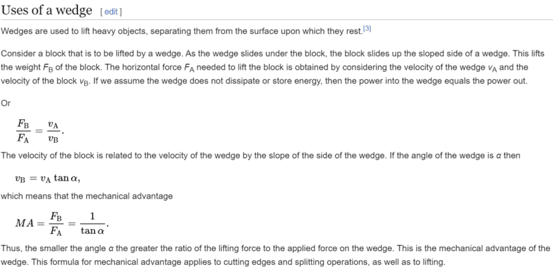

Self-locking of a conical surface starts when; Tan(wedge angle) < friction coefficient.
But it requires axial movement of the cone, which, in this case, is prevented by the steeper angle of the front-face.

@Lnewqban This is my approach to the conical section. It's more of a combination of intuition and a leap of faith so let's see if it makes sense.
I first simplified the conical section to two flat angled surfaces.
Diagram of a conical contact with a horizontal red arrow labelled F pointing right toward a wedge, two blue arrows labelled R pushing back on the angled faces, angle alpha marked between the lower face and a dash-dot horizontal line, and x+, y+ and theta+ axes at the left.
Because it's static we can say:
$$\sum F_x = 0 \rightarrow F+2R\cos (\alpha)=0 \rightarrow R=\frac{-F}{2\cos(\alpha)}$$
We can see from that how the angle causes the reaction to be bigger in magnitude just as expected.
If we assume a constant pressure field, which I consider reasonable in this scenario, then ##R## can be expressed as:
$$R=\sigma A$$
From the 2 previous equations, it is possible to obtain the magnitude of the pressure field:
$$\sigma A = \frac{-F}{2\cos(\alpha)} \rightarrow \sigma = \frac{-F}{2A\cos(\alpha)}$$
Here now comes the leap of faith. I couldn't apply Calculus the right way to obtain the expression for a continuous conical section but, based on the previous result, I feel the answer must be like this.
Diagram with axes x+, y+ and rotation theta+ at left, a red arrow labelled F pointing right toward a grey trapezoidal conical section, with a dotted blue arrow inside and angles alpha and theta marked.
$$\sigma = \left | \frac{-F}{A\cos(\alpha)} \right |\left \{ \alpha = \theta+\pi/2; \cos(\theta+\pi/2)=-\sin(\theta) \right \}\rightarrow \sigma = \frac{F}{A\sin(\theta)}$$
The 3 things to know about the last equation are:
  1. I got rid of the ##-## because it's related to whether it's going left or right and I don't care about that.
  2. The ##2## disappears because it's not 2 separated sections as it was before.
  3. I hope I didn't mistake the trigonometric identity to use the angle of the cone ##\theta##.
The area ##A## of the conical section can be calculated and I think I have that under control. Just in case I'll post a picture but I don't think it's necessary to focus on that.
Handwritten diagrams on grid paper of a truncated cone with slant lengths g1 and g2, radii r1 and r2, heights h1 and h2, a sector unrolled into a flat arc, and the integral for area A over r and theta.
Note: I used ##\beta## for the conical angle because I used ##\theta## for the variable. This may cause some confusion because I also used ##\theta## before in the drawing made in PPT to describe the angle of the cone...If all that's correct, the next step would be to check the transmission of torque due to that pressure field, distance to the center, and friction coefficient.
Then, the last bit would be to discretize the sphere in a significant number of those cones.
What do you think?
  • Diagram showing a coordinate axis set with x+ pointing right, y+ pointing up, and theta+ as a counterclockwise arc, next to a red arrow labeled F pointing right toward a blue trapezoid shape.
  • Free-body diagram of a conical section: a horizontal red arrow labelled F points right into a V-shaped gap between two angled flat surfaces, with blue arrows labelled R pressing normally onto each surface; the lower surface's angle is marked alpha.
Lnewqban said:
The reasoning in the article makes sense but I don't see why I'm getting a different result... Both things definitely cannot be simultaneously true and I can't find the error.
When I used Newton in post #28, the ##\cos\alpha## showed up.
But in the Wiki article, they use a conservation of energy argument, and then it's dependent on the tangent instead of the cosine.
Screenshot of a Wikipedia section titled Uses of a wedge, with text and equations: FB/FA = vA/vB, vB = vA tan α, and MA = FB/FA = 1/tan α.
Could both be true but be referring to different things or did I make a mistake?
  • Free-body diagram of a conical section simplified to two flat angled surfaces, with normal forces R on each surface, a horizontal force F to the right, angle alpha marked, and x and y axes shown.
