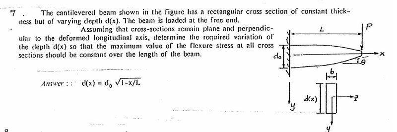

Transverse loading with varing cross section

i know that
τ=VQ/(Ib)
now I am looking for the maximum stress so i will find that at the point at the centre of the rectangle
Q=A*[tex]\bar{y}[/tex]
A=0.5*d*b
[tex]\bar{y}[/tex]=0.25*d
===> Q=0.125d2b
I=(b*d3)/12
τ=VQ/(Ib)
τ=V*0.125d2b*12/((b2*d3)
τ=1.5V/(bd)
now d changes as a function of X
i know that τ is constant from x=0 to x=L
but V is constant throughout and so is b, so how can this be?
i tried making a differential equation where i know d(0)=do and d(L)=0 using dτ/dx=0 but really didnt manage
You are calculating max shear stress, but the problem is asking for the variation in d such that max flexure stress (bending stress) under the transverse load P is constant throughout the beam. Try again using the formula for max bending stress.
am i meant to be using -y*(M/I)
i know the following
Ymax=d/2
M=PL-Px=P(L-x)
I=(bd3)/12
therefore
max stress=(d/2)*P(L-x)/((bd3)/12)
and i get
6P(L-x)/(bd2)
from here i got it thanks
