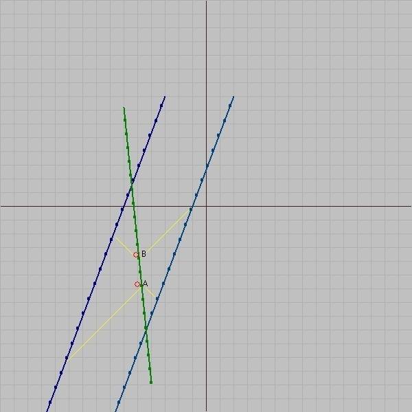

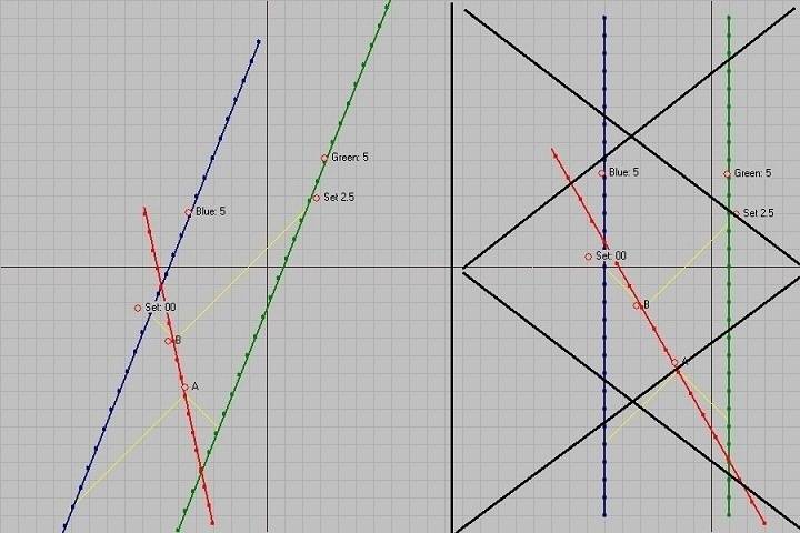

So, if you see object blue-shifted to you (I don't know how do we realize that it's blue-shifted. Franhover line? Okay, somehow we can) then using doppler factor, you will know it's speed.
You know the speed, you'll know it's distance according to bouncing signal and divide the time trip by 2 (although the object has already moved to some distance when the object bounce our signal back, and even that we can calculate the object position assuming it doesn't change velocity). No matter what clock that we see on the object (the object might have use a very inaccurate grand father clock/wall clock) we can count its time dilation according to v.
And all after that, we CAN'T synchronize clock?
What if somehow we see that there are two comoving object, we consider ourselves at rest. And through some complicated calculation, can't we just send them signals to indicate "Start reset the clock to zero"?
And we can send reset signal to the clocks according to their rest world line. Or we can even send reset signal command to the clocks according to our reset world line
Janus said:
It doesn't mean that we can't synchronize the clock ,right. What about using some algebra I supposed?
Yes. Remember that the problem isn't just time dilation; it's relativity of simultaneity. There is no absolute definition of what "at the same time" means, and clock synchronization requires defining what "at the same time" means.
This doesn't mean that one observer can't calculate what a clock, moving relative to him, reads at any event on that clock's worldline; of course he can (given that he knows the motion of the other clock relative to him). But that's not the same as clock synchronization.
Likes Stephanus
