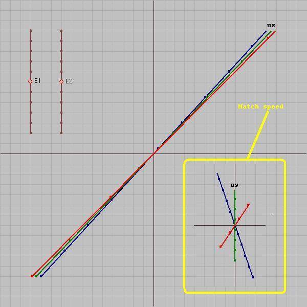

I'm sorry. I have this scenario in mind.
At event A, Green collect information from Blue. Green knows Blue left/right speed, velocity, distance, etc..
Can't Green at event B after make some calculation send command to Blue left and Blue right.
Left: "Set your clock at so and so"
Right: "Set your clock at so and so"
Green could have done that with pen/paper and watch.
  • #38
Yes, but the clock readings the Blue clocks are commanded to set will not be consistent with coordinate time in the inertial frame in which the Blue clocks are at rest. (Actually, I'm assuming this would be the case, since otherwise I don't see why you'd be raising the point. But you haven't described the calculation Green does, so we don't know what commands Green would actually send in the scenario you've described.) So this won't be "clock synchronization" in the technical sense I defined.
  • #39
So, at A. Red collects information, doppler, speed, distance.
At B, Red sends command to event "Set:00" -> "Set your clock at 00:00"
At B, Red sends command to event "Set:2.5" -> "Set your clock at 00:02.50"
I think this is how to resolve the problem. Should have calculated it of course. But I just boost the world line.
  • #40
What "problem" are you trying to resolve? Why does Red choose those particular values to send to Blue and Green? What is Red trying to accomplish?
  • #41
Ahhh, of course. Red should choose the right picture. Thanks!
[It doesn't make sense for Red to consider Blue/Green is moving. Red should convert to Blue/Green at rest]

1. A photon doesn't have a rest frame, because as pictured in the space time diagram, it is geometrically impossible to boost so that light ray is vertical?
2. An observer has to have a rest frame. But the observer can choose any moving/rest frame to make the problem easier? Is that so?
Consider this picture.
Red DOES have a rest frame, but to calculate problem such as the picture below, we can choose the picture at the right side so we can calculate simultaneity events for Blue and Green easily.
That's not the reason, but it's a way of visualizing it, yes. The reason a photon doesn't have a rest frame is the law that photons move at ##c## in all reference frames, so there can't be a frame in which a photon is at rest. In terms of the spacetime diagram, a Lorentz transformation leaves the lightlike lines (45 degree lines) invariant; it doesn't change their slope at all, so yes, the diagram correctly represents the underlying law that photons move at ##c## in all frames.
Yes. But he can't choose a frame in which a photon is at rest, because there is no such frame.

PeterDonis said:
Stephanus said:
I intended the previous post is a pure speculative question or light joke.[Add: not a joke about "light]2. An observer has to have a rest frame. But the observer can choose any moving/rest frame to make the problem easier? Is that so?
Yes. But [..]
THANKS. It helps me clear many problems! I tough this is a mathematic quiz. Like "Solve this problem with a WL moves at certain V" And we are not supposed to boost the diagram. But we can freely boost the diagram anyway we like to solve the problem.
That's why I don't didn't understand [add: CLEARLY] your post earlier.
Now I understand it. Crystal clear.
  • #58
One more question:
To solve the numbers (coordinate of events, wordlines direction) we can boost the ST diagram in any V we want.
But to imagine what the nature would look like, we should boost it again, so we are at the rest frame. Is that so?
Yes.
I'm not sure I understand. How is this different from boosting the ST diagram in any V we want?
