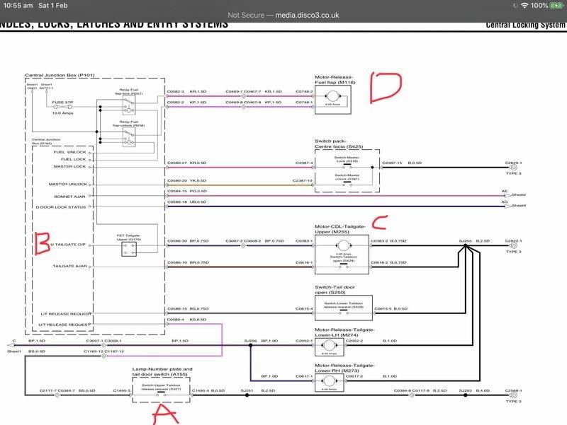

Intermittent failure of the opening mechanism on my Land Rover Discovery 4 (LR4). I’m trying to work out how the controlling FET is arranged.
Pressing the switch at (A) grounds the “U/T release request” pin of the ECU.
The “U tailgate O/P” pin at (B) then changes state and signals the FET G170.
The connector 586 pin 30 then goes high and powers the tailgate actuator at (C).
If you follow the third pin of the FET, it appears to go to GND1 (I can’t find the follow-on sheet), but is also linked into the fuel flap release motor at D. I suspect GND1 is a switched ground, allowing the fuel flap lock to release or engage, then off.
I assume the fuel flap release motor is involved so that the tailgate may only open if the car is unlocked, changing the state of the controlling relays. What I can’t work out is how the G-D-S pinout of the FET is arranged.
There is only 0.217V to ground at C3007-pin 2 (unplugged) and this does not change when requesting a tailgate open.
I suspect the FET has failed, but it’s extremely hard to get to, so would like to rule out a power feed problem involving the fuel flap relays.
FETs do not normally fail intermittent. I can't read the diagram, but the fact that the fuel flap works normally, and the rear door fault is intermittent, suggests that a connector somewhere is faulty.
Thanks - sometimes, repeatedly activating the actuator results in ‘fatigue’ and then it stops working for a bit. It might not be the FET, but a corroded or cracked solder joint.
The GND1 pin is in fact a permanent ground. Assuming the signal at (B) goes to the gate, and the source goes to the motor at (C), I assume the 12V supply must come from the unpopulated pin in the diagram.

Thanks @Tom.G - I didn’t want to flood the first post with info, but I think I’ve ruled out the actuator by substituting a new one. Also, during the fault, there is no 12V pulse at the actuator.
The car has a split tailgate - upper releases first, then you press another button and the lower releases. The lower side is working fine (on a different FET).
Both upper and lower parts latch mechanically, and are released by a pulsed movement of the actuator(s).
According to my diagnostic scanner, the tailgate open request is always received, and the ECU ‘thinks’ its sends a pulse out, but nothing appears at C0586-pin 30 (the output of the FET).
The FET has 4 pins, but none seem to connect to a 12V rail, unless this is not shown. I wonder if it’s a module with a stabilising cap to ground (lower right pin)?

Do you think the FET is switching the 12V side? What if it is switching the ground side...that looks likely to me.
The non-FET side of the motor goes to a common ground point, so I’d say it’s likely to be power side switched. My test light indicated the same thing.
At this point, the information points to item "B" of the schematic (the ECU?) having the high current switch that drives "U tailgate O/P".
The item labeled G170 (since it has only "In", "Out", and "Gnd") may be ambiguously named and serve instead as a surge protector.
See if you can check the voltage pulse at "U tailgate O/P" (item "B").
(The above approach is common "signal tracing." There is no signal at C3007-2 but signal is reportedly present going into the ECU, yet we don't know if the signal comes OUT of the ECU.)

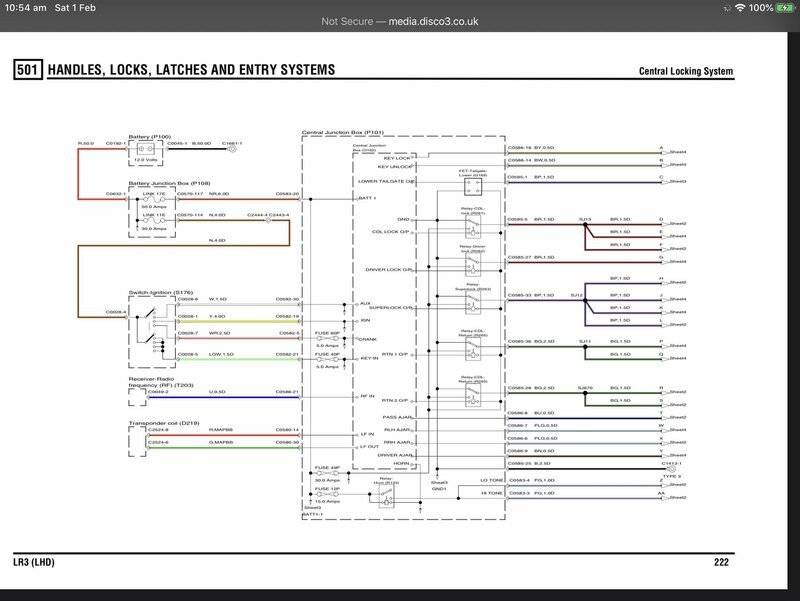

Thanks Tom, that seems a logical next step. Sadly, it will take a few hours of dismantling just to get to the area, and I’m not sure if I can probe it live as everything’s rather boxed in. In order to get to the problem area, it will have to be unplugged.
For interest, I’ve found the schematic showing the working lower tailgate FET. Note how it has in, out, ground and 12V connections.
