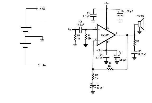

I agree, tho in this case he needs 2 batteries in series so he can produce a -V, a 0V, and a +V rail
a couple of 12V gelcells would give enough voltage at least to do basic testing, then once the circuit is working he can progress to a proper centre tapped secondary transformer and rectifier etc PSU

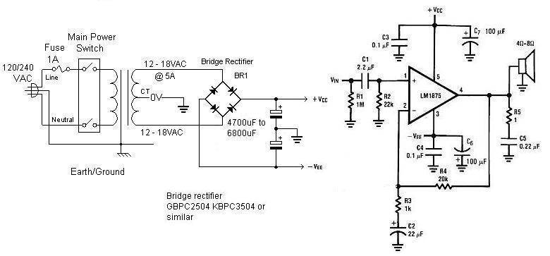

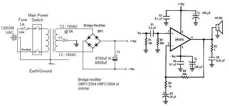

OK
taking the drawing from the datasheet, have added to the image a couple of power supply choices
here's a dual 12V 7A/H gel battery setup for initial testing...
here's a suggestion for a mains supply...
depending on how hard you want to push this amplifier, a 40V/8A centre tapped transformer would be the maximum. A 36V / 5 to 6A centre tapped transformer will power it quite well and provide a bit of current headroom
cheers
Dave

doesn't the power supply ripple filter need some (small) resistors after the 4700 μF caps (in series with the VCC and VEE to the amp)? the only way to make the ripple small is make C1 so damn big that it holds the peak voltage from the rectifier which means it only charges at very thin spikes when the diodes conduct.
in fact, you really need two C1 caps, one from VCC to common and the other from VEE to common (well, actually not the final VCC and VEE but what comes out of the bridge rectifier. it's not good enough to connect a single C1 between the + output of the bridge and the - output because it doesn't deal with any common-mode component to the ripple. both VCC and VEE could be rippling w.r.t. common yet they might seem rock solid to each other.
also, i am a little concerned about the 1 Ω + 0.22 μF load on the output of the amp. sure it ain't 1 KΩ?
Thanks rbj :)
I read this earlier and scratched my head ... then suddenly realized the error with my drawing
DOH, I should have known better, I have built enough dual rail supplies haha
OK here's the corrected diagram
cheers
Dave
