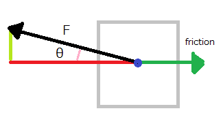

"A rope is used to pull a ##\frac{357}{100}kg## block at constant speed ##\frac{203}{50}m## across a horizontal floor. The force on the block from the rope is ##\frac{768}{100}N## and directed ##15°## above the horizontal. What are (a) the work done by the rope's force, (b) the increase in thermal energy of the block-floor system, and (c) the coefficient of kinetic friction between the block and the floor?"

Eclair_de_XII said:
(mg)(sinθ)
Please explain these factors.
That's the normal force.
How do you deduce that?
It acts perpendicular to the motion. So I suppose that it is just ##F_N=mg##.
Edit: According to Wikipedia, it is "perpendicular to the surface of contact".
I'm still not getting the right numbers:
##μ_k=\frac{(F)(cos\theta)}{mg}=0.212##
Sorry for the multiple edits.
Eclair_de_XII said:
just ##F_N=mg##.
Better, but still wrong. What forces acting on the block have at least some vertical component?
I'm guessing it's the rope tugging on the block. So is normal force: ##F_N=(mg)-(sin\theta)(F)##?
##μ_k=\frac{(F)(cos\theta)}{(mg)-(sin\theta)(F)}=0.225##
Awesome. Thanks!

Correct. The mechanical energy does not change, i.e. ##\Delta E_{mec}=0##. If the relation ##W_{block−floorsystem}=−ΔE_{mec}+ΔE_{th}=0## were correct, it would imply that ##\Delta E_{th}=0## which is not happening. Look again at the very first equation you posted under "Relevant Equations". It becomes ##W=ΔE_{th}##. That's the equation to start from. It says that the work done on the block is entirely converted into thermal energy when the mechanical energy is not changing.
