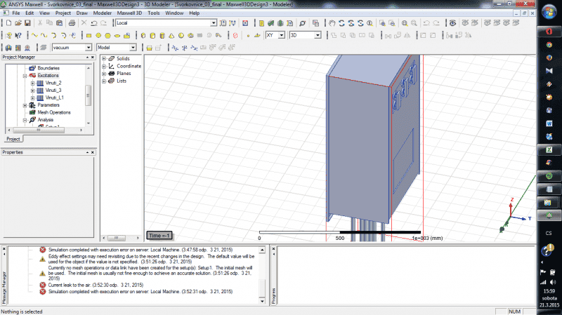

while simulating transformer core losses in transient Maxwell sollution, I have got an error: Current leak to the air.
does anyone ahev idea to solve this problem

Can you post a screenshot of your simulation and the error?

Thank you for your post, Hopefully I solved the issue. the problem was in the terminal sheet of the coil should be in the right plan.

have the same problem.
Can you please help me?

I think the pb is in the sheet that you create for the ending of coil. it should be defined in the right plan. try to choose the right plan while creating the sheet for coil.
