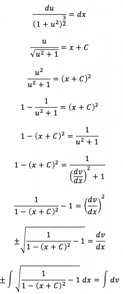

You have made a mistake somewhere in the final step. Here is what I get:

Thanks for your replies.
Zondrina: I believe that's the same answer, just in a different form as 1 = [1 - (x + C)^2] / [ 1 - (x+C)^2 ] ?

Edit: I checked your work and it's fine. Disregard what I said. I have edited my previous post.
Thanks for checking. It strikes me as odd that Matlab cannot solve this ODE and that the above procedure I used does not turn out to be a solution when back substituting for u and du/dx:

Solving the equation in post #2 yields the solution:
$$v = \pm \left[- \frac{(x+C)}{\sqrt{\frac{1}{1 - (x+C)^2} - 1}} + K\right] = \mp \left[\frac{(x+C)}{\sqrt{\frac{1}{1 - (x+C)^2} - 1}} - K\right] = \mp \left[\sqrt{1 - (x+C)^2} - K \right]$$
If there were initial conditions, you could even solve for the constants ##C## and ##K##.
Matlab's simplifier was the problem, I verified the solution by hand, thanks for the help.
