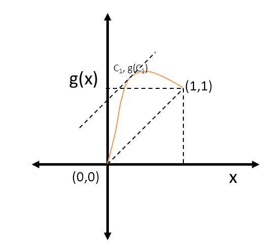

I am not sure but intuitively, I think this isn't necessarily true. For example, consider the graph shown in attachment. There is no $C_2$ in $(0,C_1)$ where $g'(C_2)=1$. What's wrong with my thinking? :confused:

Pranav said:
Hi Sudharka! :)I am not sure but intuitively, I think this isn't necessarily true. For example, consider the graph shown in attachment. There is no $C_2$ in $(0,C_1)$ where $g'(C_2)=1$. What's wrong with my thinking? :confused:
Oh sorry. As you see there's a mistake in my previous post. Using the mean value theorem (for the first derivative) on the points $(0,\, C_1)$, we can only get $f''(C_1)=\frac{f'(C_1)-f'(0)}{C_1}$ which doesn't mean a thing. I confused it somehow and thought $f'(C_1)=1$.
