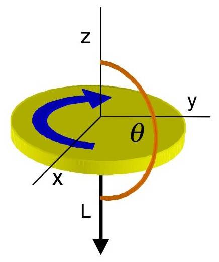

why does the angular momentum go through the z axis?
i.e for like a spinning top,
i don't get why, i would've thought it was along the x-axis due to some kind of PI product?
L=IW
It's actually located in the X-Y plane but as I mentioned above, how do you do math with "planes" or "discs" as opposed to vectors? It's just a convention to mathematically represent angular momentum as a vector perpendicular to the plane of rotation.
I'll briefly elaborate on "why cross product?" Consider the picture vorcil posted. Another reason that the cross product is convenient is that if the disk is spinning counterclockwise, the L vector will point along the +z axis. If it is spinning clockwise, the L vector will point along the -z axis. This allows you to tell which direction the disk is spinning based on the direction of the L vector.
