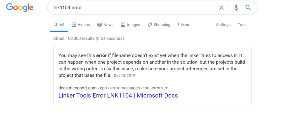

I spoke too soon. I fail to compile this program. It's a very simple program but if failed. It is EXACTLY as in the book, I checked many times and I also understand what the program want and everything is correct.

The error message is:
Can anyone see what's happened? What does that mean of cannot open the file? It's opened, I am working on it!
Thanks
Next time you get an error message, please try looking it up:
You can see from the explanation that the error has nothing to do with the program code.
I read a few this before I posted, I don't understand why.
It is strange. I copy the .cpp out, created another project, put in the EXACT source.cpp. It ran on the new project under new name.
What went wrong, that's what I don't understand.
It's even more strange, I closed VS, I try to delete the whole program folder that has problem, I can't even delete it, it said the program is opened somewhere! I closed everything. The only other thing left is restart the computer!
The message explanation refers to what amounts to a version control problem (can't find referenced file in this version) that is entirely unrelated to anything in the .cpp code.
I know now, I had to restart my computer, now everything is fine! Strange. But thanks anyway.
Restarting the computer resets environment variables including the global multi-path PATH variable.
