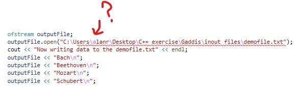

You need double quotes around the path and filename string, and because characters preceded by a backslash (\) are escaped, you need to double them up.
Code:
outputFile.open( "C:\\Users\\alanr\\Desktop\\Alan amp3\\SS\\OPS\\MOSFET\\demofile.txt");
Or you can use a single forward slash.
Code:
outputFile.open( "C:/Users/alanr/Desktop/Alan amp3/SS/OPS/MOSFET/demofile.txt");

It doesn't work, I can't find the file even though the program said it's done. this is my program.
C++:
// Read and write to file
#include<iostream>
#include<fstream>
using namespace std;
int main()
    ofstream outputFile;
    outputFile.open("C:\Users\alanr\Desktop\C++ exercise\Gaddis\inout files\demofile.txt");
    count << "Now writing data to the demofile.txt" << endl;
    outputFile << "Bach\n";
    outputFile << "Beethoven\n";
    outputFile << "Mozart\n";
    outputFile << "Schubert\n";
    outputFile.close();
    count << "Done " << endl;
    count << endl;
    return 0;
I search around, I can't find the file, it's not in the 3.29 folder.
I created the inout files folder and copy the address bar and add \demofile.txt to the end.
I was looking at the message after compile, I don't see where the demofile.txt saved.
The only thing I see in the program is the change of color as shown. It should all be RED, but the '\a' looks different. I googled, \a is alarm or alert. But alanr is the path in my computer, not much I can do.
thanks
I explained why it doesn't work in post #303. Please read more carefully the posts where members are trying to help you out.

Your string for the filename is broken. You have two options:
1) Escape the backslashes: Since the \ has a special "escape" meaning to toggle special characters in a string (e.g. \n for a newline character) you need to have some encoding for a backslash. The encoding is \\\\ . So your filename string would be "C:\\\\Users\\\\alanr\\\\Desktop\\\\ ...". That's the ugly but for some weird reason the arguably more popular solution.
2) Use forward slashes for paths. Windows understands them perfectly, and everything else uses them anyways (see the address field of your browser). Your filename string then becomes "C:/Users/alanr/Desktop/...".
