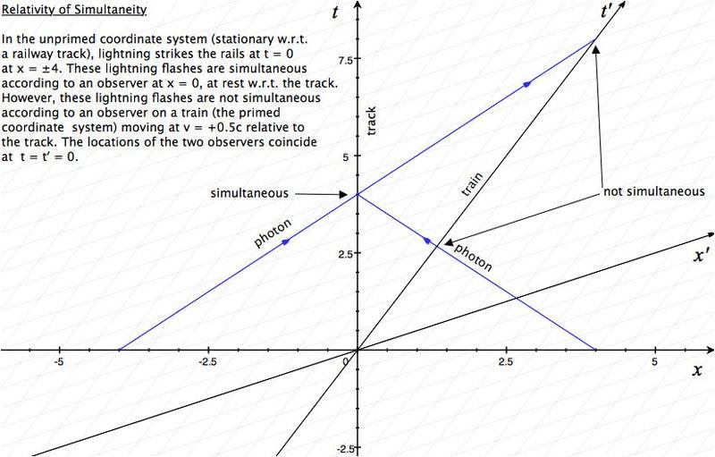

  • #31
solarflare said:
let me ask the same question but in definite terms.
the two bolts of lightning do actually strike at the same time in the trains frame of reference
the observer on the platform is exactly the same distance from each strike
does the woman see the two strikes at the same time?
This is exactly the scenario shown in the video. The answer, as stated in the video, is no.

You're thinking this must be true because the speeds are the same. Yes, the speeds are the same, but according to the passenger, the pulses do not even start at the same time.
  • #35
solarflare said:
but doc al just said yes she sees them at the same time.
My mistake, I thought your scenario was the same as the video. It is not. Doc Al is correct.

  • #40
solarflare said:
what you are doing is overlapping the platforms frame of reference with the passengers frame of reference -
Why in the world do you think that? According to the platform frame, the passenger is moving to the right (say) at speed v and the light is moving to the left at speed c (of course). So it's just simple arithmetic to realize that they approach each other at a rate of 'c + v'. All measurements were made in the frame of the platform.
if the platform observer sees the two strikes hit the train at the same time and he is equidistant from each strike then they MUST strike at the same time in the passengers frame also.
Well, no. Just the opposite. (Just repeating the same thing louder will not make it true. Why not read an introductory treatment of relativity where this is all layed out in explicit detail?)
if they strike at the same time in the passengers frame then she must see them strike at the same time also.
That part is true. "If" is the key word here.

The strikes cannot happen at the same time in both frames. See:
http://en.wikipedia.org/wiki/Relativity_of_simultaneity
[tex]\Delta t'=\gamma (\Delta t - v \Delta x / c^2)[/tex]
Since both v and Δx are nonzero then it is impossible for Δt and Δt' to both be zero.

Uh, no. The video has the light hit the train at the same time according to the platform frame and thus the flashes reach the platform observer at the same time. (The flashes reach the passenger at different times.)

If the lightning strikes occur at the same time according to platform clocks (as in the video), and at the moment of the strikes the platform observer is equidistant from the ends of the train, then the flashes will reach him at the same time.
The flashes will reach the middle of the (moving) train at different times.
solarflare said:
you are saying that if he sees the flashes at the same time then the flashes occur at different times - but if he is equidistant from the falshes then that would mean light traveled at different speeds to reach his eyes at the same time
No, the flashes will reach the woman (train passenger) at different times, who therefore concludes that according to her train clocks the lightning strikes were not simultaneous. It is a basic principle of relativity that the light travels at the same speed with respect to all observers.

If the two lightning strikes hit the ends of the train at the same time, as reckoned from the platform observer's frame of reference, then the two flashes will not arrive at the same time in the train rider's frame of reference, even though the distances between the rider and each of the two flashes as measured on the train were the same. If there were a train rider positioned at the front of the train and another train rider positioned at the rear of the train, then according to their synchronized clocks, the train rider at the front of the train would measure the flash at his location to occur at an earlier time than the train rider at the rear of the train. So the rider at the center of the train would have to reckon that the flash from the front of the train occurred first, followed by the flash from the rear of the train (if the speed of light is the same in all directions in his frame of reference).
Now, let's consider the opposite situation.
If the two lightning strikes hit the ends of the train at the same time, as reckoned from the train rider's frame of reference, then the two flashes will not arrive at the same time in the platform guy's frame of reference, even though the distances between the platform guy and each of the two flashes as measured on the ground were the same. If there were a platform guy positioned exactly at the location of the front lightning strike and another platform guy positioned at exactly the location of the rear lightning strike, then according to their synchronized clocks, the platform guy at the location of the front lightning strike would measure the flash to occur at a later time than the platform guy at the location of the rear lightning strike. So the guy at the center of the platform would have to reckon that the flash at the rear of the train occurred first, followed by the flash at the front of the train (if the speed of light is the same in all directions in his frame of reference).
Chet
