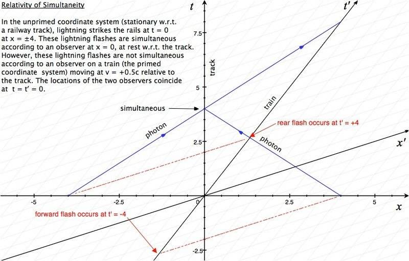

  • #76
I made this spacetime diagram a while ago, and I *think* it corresponds to the original scenario that is being discussed here. Maybe it will help. The "worldline" of the train (which is its path through spacetime) is clearly indicated, and it of course coincides with the t' axis:
The worldline of the photon that is coming in from the front (i.e. from the positive side) clearly intercepts the worldline of the train before (i.e. at a smaller value of t') the worldline of photon that is coming in from the rear (negative side) does.
The coordinate grid I've drawn is for the train observer, in the primed (t',x') coordinate system.
  • #77

  • #78
this diagram says that if the stikes happen simultaneously - on the tracks - the the observer will see them simultaneously also. just at a different time.

Sure. The lightning struck the ends at the same time in her frame and since they traveled the same distance they reach her at the same time. No mystery there.
the diagram shows that the lightning struck in the trains frame of reference simultaneously and also in the platform observers frame.
so according to Doc Al's statement above the train observer will see the bolts a the same time also.
  • #81
The observer on the tracks will see them simultaneously, not the observer on the train.
No it doesn't. The diagram shows that the flashes are not simultaneous in the train frame.
And no again.

  • #85
the lines being drawn from the x-axis are at -4 and +4 but both are at t=0
  • #86
Yes. The lightning strikes are simultaneous in the platform frame.

  • #88
the x-axis is the train frame because that is where the light originated from - there are two train frames - one when the lightning strikes the train and one when the light reaches the passenger
  • #89
The x-axis measures distance according to someone on a stationary platform (that is, someone standing talong the track).
The diagram is very clear. The two photons' worldlines cross the platform/track observer's worldline at the same time (as expected) but do not cross the train observer's worldline at the same time. Hence, they do not reach the train observer at the same time. They cannot be perceived simultaneously in this situation.
  • #90
No, the x-axis is the platform frame. The lightning strikes do not originate in a frame, they happen in all frames. The x' frame is the train frame.
Don't confuse events (such as: lightning striking the front of the train, lightning striking the rear of the train, light from the front of the train reaching the passenger) with frames. In this analysis there are two frames of interest: the platform frame and the train frame.
