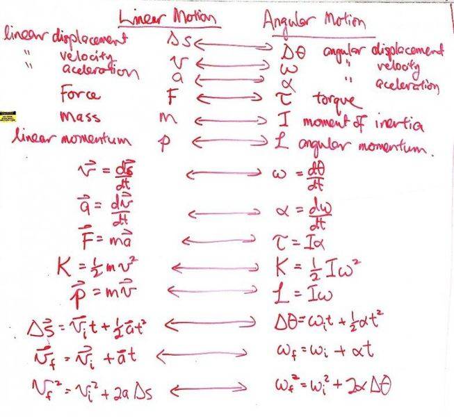

This is a scan of what I have written on the white board in my class to drill into the students that rotational motion is no different than linear motion.
If you can do linear motion problems, but you can't do rotational motion problems, then you need to figure out why you are having problems here.
Zz.

I know they look all the same..I really don't know where I am doing wrong.Thanks :)
I guess I understand.In kinematics its simple,m/s m/s^2 that's all. Here,rad/sec rad/min rev/s rev/min and sometimes there's angels sometimes f sometimes we convert that w and makes me confused everytime
I looked my book once more and I can do most of the questions now,just amazing
