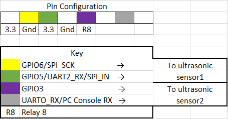

The pins that are connected use the following:
  • UART_RX/PC Console RX
  • GPIO3
  • GPIO5/UART2_RX/SPI_IN
  • GPIO6/SPI_SCK
(Excluding the power and ground pins.)

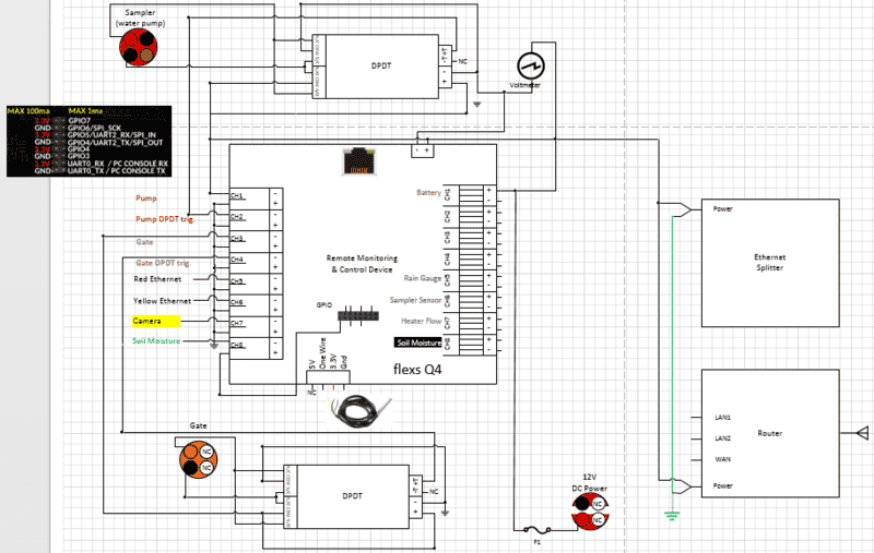

https://flexscada.com/manuals/flexsq4/
  • GPIO3
  • GPIO6/SPI_SCK
Wiring schematic of a remote monitoring and control device, flexs Q4, with a DPDT relay, router, Ethernet splitter, 12V DC power supply, and a GPIO pin table listing pin functions.

  • Wiring schematic of a remote monitoring and control device, flexs Q4, with a DPDT relay, router, Ethernet splitter, 12V DC power supply, and a GPIO pin table listing pin functions.

Spreadsheet-style pin configuration table: top row shows 3.3, Gnd, 3.3, Gnd, R8 with coloured cells, and a key below mapping yellow GPIO6/SPI_SCK and green GPIO5/UART2_RX/SPI_IN to ultrasonic sensor1, purple GPIO3 and grey UARTO_RX/PC Console RX to ultrasonic sensor2, and R8 to Relay 8.
(There are two MB7380 ultrasonic sensors.)
  • Spreadsheet-style pin configuration table: top row shows 3.3, Gnd, 3.3, Gnd, R8 with coloured cells, and a key below mapping yellow GPIO6/SPI_SCK and green GPIO5/UART2_RX/SPI_IN to ultrasonic sensor1, purple GPIO3 and grey UARTO_RX/PC Console RX to ultrasonic sensor2, and R8 to Relay 8.

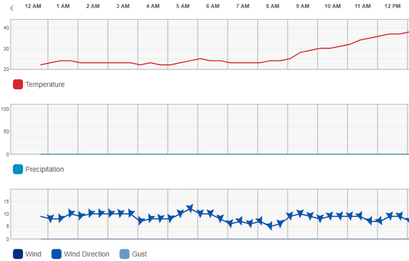

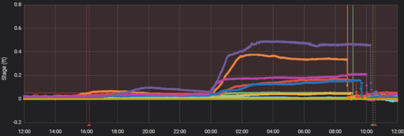

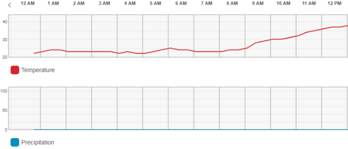

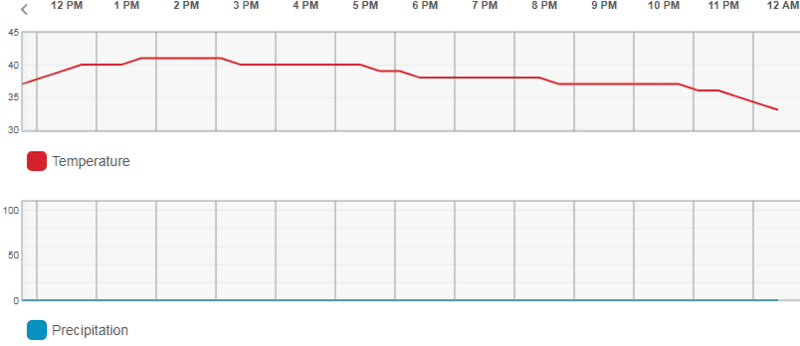

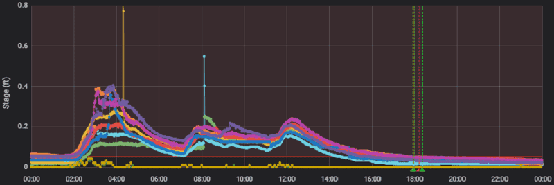

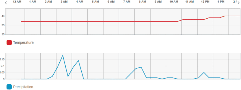

For the most part, the eight sites give good data. Sometimes one or two do not. It varies among the sites too.
Take rainfall for example:
Line graph of stage in feet from 12:00 to 12:00 next day, with about eight coloured series; most stay near zero, while purple, orange, magenta and red series rise sharply around midnight to 0.2 to 0.5 ft before dropping near 10:00.
Fig. 1. Several sites giving inaccurate data: no rainfall on this day--even though one site says that half-a-foot of rainfall occurred! Bad.

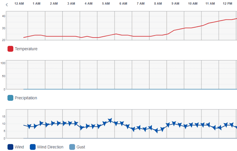

Two paired line charts of temperature in red, one per day, with precipitation charts below them showing flat lines near zero, all plotted against hourly time labels.
Fig. 2. Proof that no rainfall happened that day from the local airport.
Line graph of stage (ft) from 00:00 to 00:00, with several coloured series rising to about 0.4 ft around 03:00-04:00, a sharp spike near 08:00, and a red horizontal reference line near 0.05 ft.
Fig. 3. Shown is accurate data for another day (with two instances of an unreasonable spike). Good.

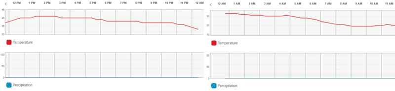

Line graph of temperature (red, top) and precipitation (blue, bottom) against time from 12 AM to 2 PM; temperature rises from about 37 to 40, precipitation peaks near 0.18 around 3 AM.
Fig. 4. Proof that rainfall happened (this other day) from the local airport.---
For this sensor, I too thought, why not just wave your hand under the ultrasonic sensor and read it from the Q4...but from the data being collected, it seems that all these systems are working. It is just that some days there is highly inaccurate data.

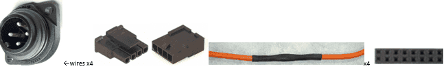

The GPIO pins are connected like this:
Left to right: a circular panel-mount connector with four pins, a pair of brown four-pin Molex connector housings, a short orange and black wire with heat-shrink tubing in the middle, and a black pin header next to a black socket strip.
Sensor (not shown) → Hirschmann plug → four 20 AWG gauge wires → molex 3.0 microfit connector male → female → heat shrinked tubing in the middle of each of the four wires → GPIO header on Q4 logger
  • They needed to connect them together (with the molex connectors) because that gauge of pre-crimped cables only come in 10" segments.
  • The heat shrinked tubing part changes the gauge of the wires. It goes from 20 AWG to 25 or something higher.
Are you thinking that there are transmission life effects? or load impedance mismatch going on?
  • Left to right: a circular panel-mount connector with three pins, two black plastic Molex connector housings with four pin cavities, a short orange wire with a black heat-shrink section in the middle, and a 2x10 pin header.
  • Left to right: a circular panel-mount connector with four pins, a pair of brown four-pin Molex connector housings, a short orange and black wire with heat-shrink tubing in the middle, and a black pin header next to a black socket strip.
What are the lengths of wire and datarates involved? I saw SPI serial links mentioned earlier in the thread -- what is the SPI clock rate? If it's a normal fast rate and the wire is over a few inches, you should likely use "back termination" resistors to minimize reflections and the resulting signal ripple and closing eye diagram plot.
I do not know the sensor cable length, but from the Hirschmann plug: Ten inches, molex connector, ten inches.
All I can find on the Q4 datalogger are instruction manuals, not datasheets.
berkeman said:
Also, are you using twisted pairs for the signal+GND cables?
The only connections are the precrimped wires to the molex connector sockets, and whatever's under the tubing. Each wire is independent.
