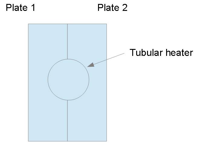

Hi,
I have a machine equipped with 2000mm long tubular cartridge heater (230V, 1600W, 4mm diameter). This tubular heater is sandwiched between the two steel plates (2000mm long) i.e. the heater keeps the steel components hot. My problem is that the temperature of the steel components varies along the heater +/-15degC (nominal T=190degC).

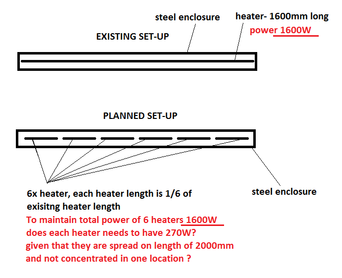

In order to maintain more uniform temperature along the steel components, I intend to replace the exisitng heater, 2000mm long, with 6 heaters, 325mm long each (there wil be approx. 8mm gap between each nearby 2 heaters). Each 325mm long heater will be powered and controlled separately. But all 6 heaters will be controlled in the way to maintain the same temperature in the steel based on the feedback from 6 thermocouples. The total power (wattage) of all 6x325mm long heaters will be the same as in case of 2000mm heater, i.e. 1600W.
Please also refer to the attached draft.
My question is:
Question 1
Does it mean that I would need to basically divide the power of 2000mm long heater, i.e. 1600W, by 6? What gives me approx. 270W per heater.
(If yes, I would then add perhaps 20% of power to each heater for some headroom, i.e. 270W+20%= 324W).
I have some doubt in regards to this solution because 6 heaters will be spread on the length of 2000mm and I am not sure whether simple dividing 1600W by 6 is adquate here.

The text indicates a 2000mm long heater is currently used, but the drawing shows it as 1600mm.

These steel plates that are heated - are they parts in the machine?
The idea of dividing total power into the number of heaters is valid. However, cold spots occur where heaters butt up against one another in the 'planned' drawing, partially due to the spacing between them, and partially because each heater element has a 4 to 8 mm dead spot at each end for the electrical terminations. Is it possible to stagger the heaters so they overlap?

The steel plates are the components of the machine. Unfortunately, it would be very challenging to overlap the heaters to avoid the cold spots.
These plates have hundreds of holes and grooved channels (where the polymer flows) so there is no space for other than linear array of short (325mm long) heaters.

I'm trying to visualize what this installation looks like in cross-section. Do the plates tangentially touch the outer heater surface, or are they machined so the heater is in good contact with them along the lines of this illustration?
If the latter, have you tried using a heat transfer compound between heater and plate? For this temperature range, very finely powered graphite and aluminum in a silicone or mineral oil base has been successfully employed, and is commercially available. If temperature variation is caused by uneven contact between heater and plates this should bring it under control.

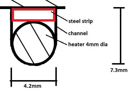

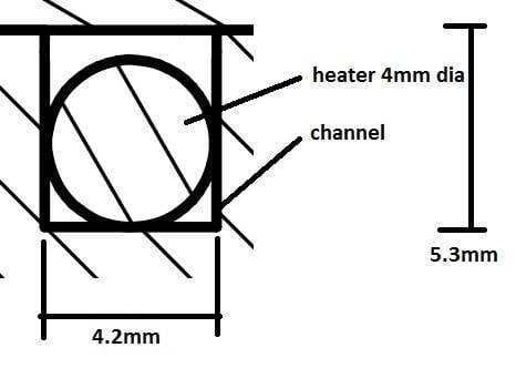

Unfortunately, the channel which accommodates the heater is of square shape and is too deep, please refer to the attached draft on left side, therefore is not ideal for the round heater.
The steel parts are of old design but for a moment I need to go ahead with them because they are too expensive.
I considered two actions in order to temporarily fix the problem of square channel and round heater. Please refer to the draft on right side.
I think about making the channel slightly deeper with a round mill (4mm dia), so at least half of the channel (bottom part) would be in a good contact with the heater and then I would add a mild steel strip over the heater. The compound would be added there. However, the problem is that the two steel plates needs to be firmly tighted (there is 1mm aluminium gasket between them) two avoid any polymer or hot compressed air (which also flows through hundreds of channels in these plates) leakage. Thus the strip inside the channel would need to be only in a slight touch with the heater.

Do you have issues with limited heater lifespan, too? 1600W in a 2000mm x 4mm tube is about 41 watts/square inch of watt density. This yields higher than desirable sheath temperatures wherever heater-to-heated object contact is poor.
I'd try rounding the bottom of the channel with a 4mm ball mill as you've described. Rather than a flat strip on top, however, make it appropriately deeper, and round it with the same 4mm ball mill so it also is in good thermal contact. Do this before experimenting with multiple elements and heat zones - basic geometry improvements will go a long way to even out thermal distribution within the plates, and perhaps enough that multiple zones will no longer be necessary.

... the channel which accommodates the heater is of square shape and is too deep, please refer to the attached draft on left side, therefore is not ideal for the round heater.
Is it possible the tool builder originally designed it using a square or rectangular heater? I've never used them (in fact, I didn't know they existed until now), but several firms manufacture such heaters. Here are links to two of them.
http://www.fastheatuk.com/cartridge.html
http://www.duratherm.com/square-cartridge-heaters/
4.2mm x 5.3mm isn't a standard size, and 3/16" (4.76mm) is the smallest I've seen so far (there may be issues fabricating cartridge elements under this size), but it's worth discussing the possibility of manufacturing a custom rectangular heater with your supplier.
Or how about filling/packing that void around the heater with ceramic powder as a thermal transfer medium? Possibly without even having to disassemble it.
P.S. Rather than paying for ceramic powder, you could even use sand as used for sand blasting.
