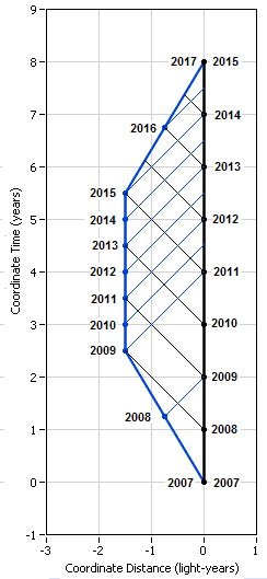

  • #40
A.T. said:
ghwellsjr said:
Is your point for the scenario in this thread that it doesn't apply to the Twin Paradox because neither twin is inertial?
I think that it is an interesting variation, which demonstrates that not only the total amount of proper acceleration matters, but its timing. It leads to a more general explanation of the asymmetry, which also applies to the classic version.
Ok, good.
A.T. said:
ghwellsjr said:
So the only kind of answer that you will accept is one that shows an inertial explanation for the inertial twin and simply asserts that no such explanation applies to the non-inertial twin (simply because he is non-inertial)?
It is okay to assert that an "inertial explanation" doesn't apply to the rest frame of the non-inertial twin, if that is what you mean. But ideally you would also provide a non-inertial explanation for the non-inertial twin's rest frame, which leads to the same result as the rest-frame of the other twin.
Isn't that what I did in these threads:
https://www.physicsforums.com/showthread.php?t=670653&page=10 post #135
https://www.physicsforums.com/showthread.php?t=644948&page=6 posts #92 and #93
https://www.physicsforums.com/showthread.php?t=671398&page=3 posts #35 and #36
In each of these three cases I provided an inertial spacetime diagram for the stay-at-home twin's inertial rest frame and a non-inertial spacetime diagram for the traveling twin's non-inertial rest frame and yet none of the OP's for which I provided these diagrams responded with any statement to the effect that they understood the diagrams. I just don't know if they are effective.
A.T. said:
ghwellsjr said:
So when the questioner correctly points out that in the inertial twin's rest frame, there is a constant Time Dilation for the non-inertial twin (assuming instant turn-around), but the rest frame for the non-inertial twin is non-inertial and so it is an incorrect comparison and we simply stop right there. We just call foul?
This is what most "explainers" do. And I think it is not satisfying to most questioners. I would like to see it explained from both frames.
Didn't I explain it from both frames and didn't I show that both rest frames lead to the same results?

  • #47
I don't understand them either.
I don't understand the phase where they have constant separation. In reality the blue signals send during that phase should arrive blueshifted, but there is no movement of the source in the diagram. If the signals are simply a picture seen through telescope, the angular size of blue twin, as seen by black twin would be increasing after turnaround. But in the diagram the viewing distance is constant for a few years.
I think it is very difficult to make a smooth and correct diagram for the sharp turnaround version. The simpler case might be the one with constant proper acceleration, then you have just one coordinates chart (Rindler) for the rest frame of the accelerating twin, not two that you have to merge somehow.
See Fig 7:
http://cds.cern.ch/record/497203/files/0104077.pdf
  • #48

  • #49
In this version of radar coordinates the horizontal does not represent proper distance along a simultaneity surface. Instead, it represents 1/2 round trip travel time for a signal (from traveler to home and back) as measured by sudden turnaround traveler, times c. For classic sudden turnaround, there is, indeed, a period of time when such signals have constant round trip time. Proper distance along the same simultaneity lines would produce a different diagram. And, of course, since the diagram is drawn from traveler perspective, the simultaneity lines are straight.
  • #50

  • #54
The diagram uses radar coordinates, the same approach as Einstein's convention, but applied to a non inertial observer. Since the resulting coordinates are non inertial you can get red and blue shifting without relative motion. I.e. The standard inertial frame formulas don't apply.

Since the writer of a paper is so familiar with their own material, there is
always the possibility for the reader to misinterpret or not understand some
parts due to insufficient details, excessive complexity, verboseness,
mistakes, etc. Having experienced this as a reader, this is an attempt at an
improved version of the original post.
https://www.physicsforums.com/attachments/56188
