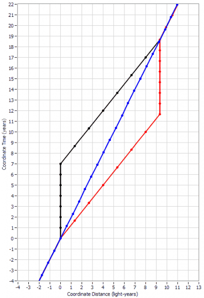

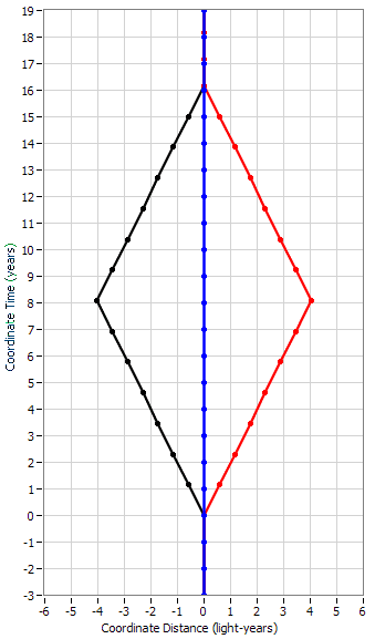

As mfb asked, t1 in which frame? We could say it is the Coordinate Time in frame F and that is what I think you mean but A and B will not have any way of knowing when that time occurs. We could also say that they each individually turn around when their own clocks reach a certain Proper Time value which will be that same Coordinate Time for themselves in their individual rest frames up to the point of turn around but it won't be the same Coordinate Time for the other one. I'll show you some spacetime diagrams to illustrate these different times starting with frame F:
Spacetime diagram with coordinate distance in light-years on the horizontal axis and coordinate time in years on the vertical axis; a blue vertical line at distance 0 shows the stationary observer, a red path and a black path leave and return to it forming diamond-shaped worldlines that turn around at time 8.
A is shown in red, B in black and blue is an observer who remains at rest in F throughout the scenario. The dots represent one-year increments of time. So the Proper Time for A and B when they turn around is 7 in this example and they spend another 7 years getting back so their total age accumulation during their trips is 14 years and they get back to F when he has aged just over 16 years.

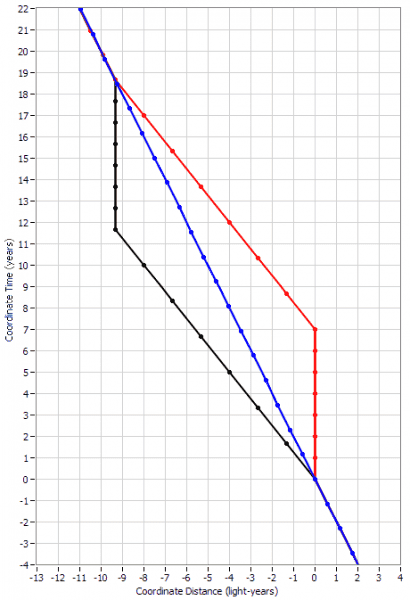

From A's point of view, B has taken a journey at a relativistic speed more than c/2 and less than c.
This is only partially true. In A's rest frame up to the point of turn around, B is traveling away from him at 0.8c but B doesn't turn around until some later at which point he comes to rest in that frame:
Spacetime diagram in frame F with coordinate time in years on the vertical axis and coordinate distance in light-years on the horizontal axis, showing three worldlines: red, black and blue.
If we look at A's rest frame after he turns around, we see that B is approaching him at 0.8c but B has already turned around much earlier:
Spacetime diagram in coordinate distance (light-years) against coordinate time (years) showing three worldlines: a blue line for an observer at rest, and red and black zigzag lines for two travelers who turn around at different coordinate times.
doaaron said:
Therefore, A should expect B to be younger than him after the journey.
No, not if he is applying SR correctly. He should expect them to be the same age as we can see from any of the above three Inertial Reference Frames.
doaaron said:
From B's point of view, A has gone on a "relativistic" journey, and expects that A is the younger.
B has the same issues that A has and should come to the same conclusions. You can just interchange the last two diagrams to apply everything to B.
