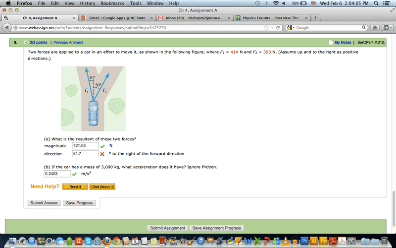

Here is my given diagram and problem:
I'm stuck on finding the direction. I tried using the equation theta=tan^-1(Ay/Ax), and the answer was incorrect.
As you can see, I have the acceleration and the magnitude of the vector correct. My value for Ay=0.2378 and my value for Ax=0.03487. I know these are the correct values because I had to use them to find the other parts of the question, which are marked correct. This is what I did:
theta=tan^-1(0.2378/0.03487)
=81.7* It was marked incorrect on Webassign.
Where did I go wrong?
Thanks!
You've given the angle with respect to the positive x-axis.
They ask for it "to the right of the forward direction"
