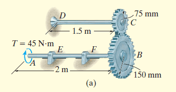

Two solid steel shafts are coupled together using meshed gears. Determine the angle of twist of end A. Shaft DC is fixed at D.
angle of twist = torque * shaft length / ( polar moment of inertia * shear modulus)
balance of forces where the two gears mesh:
150mm * Fab = 0.75mm * Fcd
I know the solution, but am puzzled about what is wrong with the following approach:
The sum of forces and moments on the system must equal zero since the system is at static equilibrium. Since torque exerted on the system at A is 45Nm, the torque exerted on the system at D must therefore be -45 Nm.
However, balancing forces at where the two gears mesh shows that torque at D is really -22.5 Nm.

To balance torques, they must be about the same axis.
