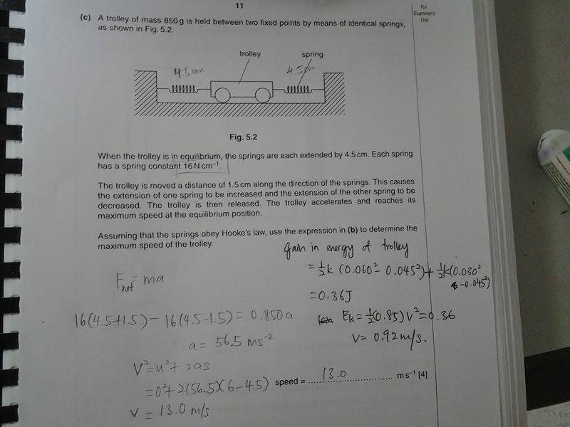

Please refer to the image.
My workings= pencil
Answer= pen
Why is my working wrong? What wrong assumptions did I make?
Hooke's law/Newton's second law/ Elastic potential energy =0.5 kx^2
As shown in the image.
  • Handwritten worked solution on an exam paper for a trolley held between two springs: a diagram of the trolley with springs each extended 4.5 cm, then pencil working for net force, acceleration of 56.5 m/s^2 and speed 13.0 m/s, and pen working for energy giving 0.92 m/s.
You used a kinematic formula for uniformly accelerated motion. That won't apply here, since the acceleration varies with displacement.
Stick to energy conservation.
What is the total spring PE at equilibrium?
What is the total spring PE when the trolley is displaced?
