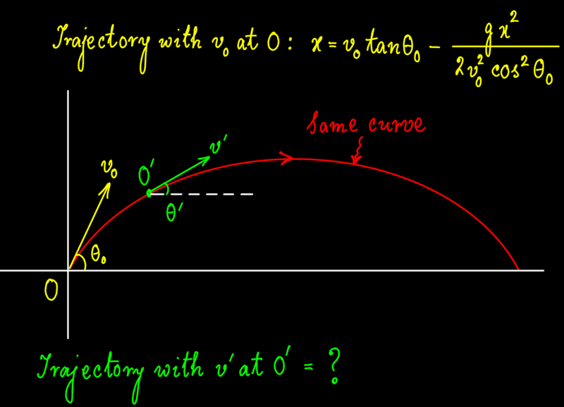

I copy and paste my working below.
This is the answer from the book, but it makes reference to the details of projectile motion, so perhaps less suitable. I suspect the way to the answer is @Orodruin 's method in post#5, which I will do in a moment.
As you see in the posts above, I am stuck with a conceptual problem - namely, should the equation of the trajectory of a projectile change if one were to effect a change in its coordinates to some point along the trajectory?

  • #32
Imagine you fire a projectile straight up and want the speed at the origin, which was the original starting point. First, you move the origin to the highest point, where the speed is zero and that's your answer?

  • #34
brotherbobby said:
I am sure you phrased the question incorrectly. Can you rephrase it for me?
I think you should focus on the problem you started with. As a separate exercise you might want to study some graphs and look at how their equations change when you translate the ##x## and ##y## coordinates.
If you don't like taking ##t = 0## at the origin, then take ##t = t_0## at the origin. Or, use the alternative method using derivatives, where you don't need to introduce the time parameter.
In any case, you don't need the parameter ##\theta##. That unnecessarily complicates the working. You are already given ##p## and ##q##. That's what you should be working with.

Yes, I got it. Let me copy and paste the solution to the problem. Better still, since we have had plenty to discusss and digressions along the way, let me start with the problem itself.
Problem statement :Solution :
Given the equation of the curve : ##y = px-qx^2##. Thus
\begin{equation*}
\begin{split}
\boldsymbol{\dot y}& = \boldsymbol{p\dot x-2qx\dot x}\\
\Rightarrow \dot y(O)& = p\dot x(O)\quad [x(O) = 0]\\
\Rightarrow v_y(O)&=pv_x(O)\quad\quad \mathbf{(1)}
\end{split}
\end{equation*}
Differentiating the bold equation above again, we get
\begin{equation*}
\begin{split}
\ddot y& = \cancel{p\ddot x}-2q\dot x^2-\cancel{2qx\ddot x}\quad [a_x=0\rightarrow \ddot x=0, x(O)=0]\\
\Rightarrow \ddot y(O)& = -2q\dot x(O)^2\\
\end{split}
\end{equation*}
But it is given that ##\ddot y = -a_0##, since the acceleration is directed downward. Hence from above, we obtain ##-a_0 = -2q\dot x(O)^2\Rightarrow v_x(O) = \sqrt{\dfrac{a_0}{2q}}\quad\quad \mathbf{(2)}##
Using (1) above (2) above, we have ##v_y(O) = \sqrt{\dfrac{a_0}{2q}} p##
But ##v(O) = \sqrt{v_x(O)^2+v_y(O)^2} \Rightarrow \boxed{\boldsymbol{v(O) = \sqrt{\dfrac{a_0}{2q}(1+p^2)}}}\quad\color{green}{\Huge{\checkmark}}##.
This agrees with the answer in the textbook.{The problem fades in importance to the critical point I gathered during my discussions with @PeroK - namely, that the equation of the path of a projectile ##y(x) = px-qx^2## is true only for the initial velocity ##v_0## defined at the origin. I am yet to show how this is true, and the thread therefore remains unresolved}
