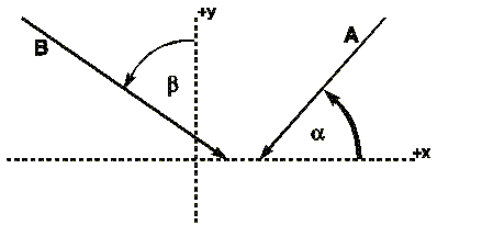

The diagram below shows two vectors, A and B, and their angles relative to the coordinate axes as indicated.
DATA: α=45.7°; β=55.6°; |A|=3.50 cm. The vector AB is parallel to the −x axis. Calculate the y-component of vector B.
rsinθ=y
A-B is parallel to x so A_{y} must equal B_{y} ? Therefore, 3.5sin45.7 = A_{y} = B_{y} = 2.50 cm ; which is wrong. I'm a bit confused here. It tells me "Since the sum vector (AB) has no y-component, vector A must have the same y-component as vector B. As shown, 'east' is for +x, and 'north' for +y, thus the answer can be negative. " Did I mess up the calculation?

Why do you say it's wrong? They haven't given you a magnitude for B so you just need to choose a magnitude for B that, given its angle, makes its vertical component equal to 2.50.
It's part of an online assignment, to which when I enter 2.50 cm it tells me it's incorrect.
Perhaps they really meant to ask you the magnitude of B, because if they didn't want that they wouldn't have needed to give you the angle ##\beta##. Try calculating and entering that and see if it accepts it.
If that doesn't work, the next thing I'd try is the x component of B.

Perhaps they want a minus sign on the 2.5. The word 'component' can refer either to an unsigned vector or to a signed scalar. If they mean the latter, the answer would be -2.50 since the vertical component is downwards and the positive y direction is up..

I still don't understand though. So is it that if the vector is 'moving downwards' in a Cartesian plane, the y-component, regardless of the quadrant it resides in, will be negative? Vice versa for 'moving upwards'?
Yes that's right, although it would be more accurate to say pointing downwards rather than moving.
Vectors don't have a location. A vector is just a direction and a magnitude. In fact it's a little odd that the two vectors are drawn the way they are, rather than head-to-tail as is the usual convention. I guess that in this case they didn't want to draw them head to tail because they want you to calc things about both A - B and A + B and those two give different head to tail diagrams.
The y component of A is -2.5. The y component of A - B is yA - yB=0. Therefore, yB=yA= -2.5

What are the x- and y components of the vectors A and B?
A_{y} = 2.5
B_{y} = -2.5
A_{x} = 2.44
B_{x} = 3.65 (-3.65? it shouldn't matter since Pythagoras)
We did:
[tex]\sqrt{(2.44+3.65)^{2} + (2.5+2.5)^{2} } = 7.88 cm[/tex]
Which it tells me is wrong.
Would A+B be parallel to the y-axis?
No. In the figure, is the x component of A positive or negative? In the figure, is the x component of B positive or negative?
Chet
Chet
I got it now, thanks. Answer was 5.14 cm
