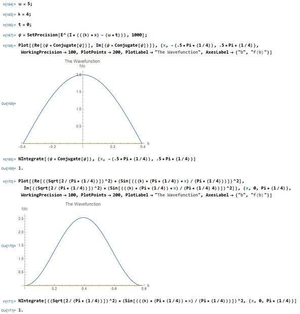

After watching this video: which explains why the wavefunction in an infinite square well is flattened, I tried running the calculation in both, what seems, the more more traditional way of using sin and by the method of, what seems to be, adding the wavefunction and its complex conjugate. Though both results integrated to one and had an arc spanning from one side to the other, the sin version has more curvature at the bottom and a peak of 2.5 while the other had not as much curvature and a peak of two. What am I missing here?
I've attached a picture of my mathematica notebook.
Can't read what you are plotting (too many brackets for my brain), but one is a sine and the other is a sine squared
If a=Pi/4 is the length of the infinite square well and k=4, then the first graph (and integral) is Psi+Psi* and plotted over a range of a. The second graph and integral is (2/a)*Sin^2(kx) also plotted over a. Sorry for all the artefacts. I hadn't cleaned that up since manipulating it.
To be clear, what I'm wondering is if Psi+Psi* is supposed to equate to the more traditional solution to the infinite square well which is Abs[Psi sub x]^2=(2/a)*Sin^2((n*Pi*x)/a) and if so why I'm not getting that. And if not, why does the video seem to be suggesting that (starting at about 1:59).

Okay, yes, that's what I was trying to say. Does all that equate to a second way of getting this solution which involves adding Psi and Psi* as seems to be implied in the linked video at time stamp 1:59~ and if not why does the video seem to be suggesting that?
As I said, I don't understand what it is about this ##\psi## and ##\psi^*## thing. Up to an indetermined phase factor (which one usually sets tacitly to 1, as done above) the normalized energy eigenfunctions are unique and real. The latter is, because the potential is symmetric under reflection at the point ##L/2##.
So is the video wrong or am I misinterpreting it?
