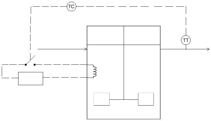

Hello, PF! I've been learning some process control on my own lately, and some questions have come to my head while on it.
Consider the following on-off control loop:
Process and instrumentation diagram of a tank with a dashed signal line from a TC controller to a TT transmitter, a heater coil, and an actuator block at the lower left.
Let's say we want to control the temperature of the fluid inside the tank. We set up an on-off control loop and establish a temperature set point [itex]T_{sp}[/itex], then we measure the outlet temperature of the fluid [itex]T[/itex]. As long as [itex]T < T_{sp}[/itex], the controller activates a constant-power electrical heater, and it turns it off once [itex]T < T_{sp}[/itex]. Now, I know this is a very rudimentary description, but I think it gets the job done. Let's say the controller is a PLC, so we set up our ladder logic program with an open contact for the temperature sensor input that gets energized as long as [itex]T < T_{sp}[/itex], and the corresponding output coil for the electrical heater. Clearly, this system can run on digital signals only.

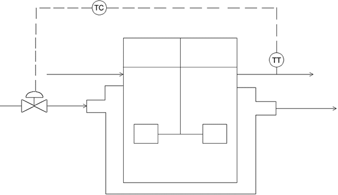

Now, consider the following PID control loop:
P&ID-style diagram of a jacketed tank with a control valve on the steam inlet, a TC controller and a TT transmitter linked by dashed signal lines, and an agitator inside.
Now we have a steam heating jacket, and we can control its mass flowrate using a control valve. Now we need an analog temperature sensor which provides a continuous reading of the outlet temperature. Let's say we're still running the control loop on a PLC, so we need analog I/O modules in order to receive the analog signals from the sensor, and send the output signals to the valve actuator, which should adjust mass flowrate accordingly. Now, this system runs mostly on analog signals, at least the instrumentation has to.

1. Do on-off control loops mostly run on digital signals? As a process control newbie, I don't see the need for an on-off loop using analog instrumentation.
2. Do PID loops always imply analog instrumentation? Could a PID loop run on just digital hardware?
3. PID loops seem to be ubiquitous in the chemical processes industry, are on-off loops used at all as an alternative to PID control? Not when accuracy is critical, I think.

MexChemE said:
Now, my questions are:
There is no hard and fast rule regarding the instrumentation. It depends on what type of sensors and controls are available that fit the requirements (cost, power capability, temperature limits, etc.) If there are analog components, there will need to be some conversion between discrete and analog somewhere.
Classical analysis of PID circuits assumes that the signals are continuous, not on/off discretes.
For all practical purposes, yes. Converters for analog-to-digital and digital-to-analog are common for the I/O of digital computers.
On-off controls are called "bang-bang" controls. They are usable in far fewer applications. If there are system components with significant dynamic behavior (lags, leads, etc), the continuous PID controller is much more flexible. Your second example, with an entire jacket that must warm up would have a significant lag in warming the fluid and then it may warm the fluid far beyond the desired temperature. A PID controller is better for that situation. In fact, the first example would also have some lag.
EDIT: Although PID controls are more flexible, discrete on/off controls are very common. Thermostat control of home furnaces and air conditioners, stoves, electric blankets, etc. If they control it well enough, they are much simpler.
Nice response! I did notice on-off control loops are much more used in home appliances and the like (almost any introductory discussion on process control mentions the home heating/cooling situation with an on-off loop), and not so much in a more industrial setting, such as the examples I sketched. However, as you point out, it would all depend on the needs of the project. For example, if the dynamic behavior of the system is stable (I'm not sure my terminology is correct), an on-off loop would be more feasible than a PID.
