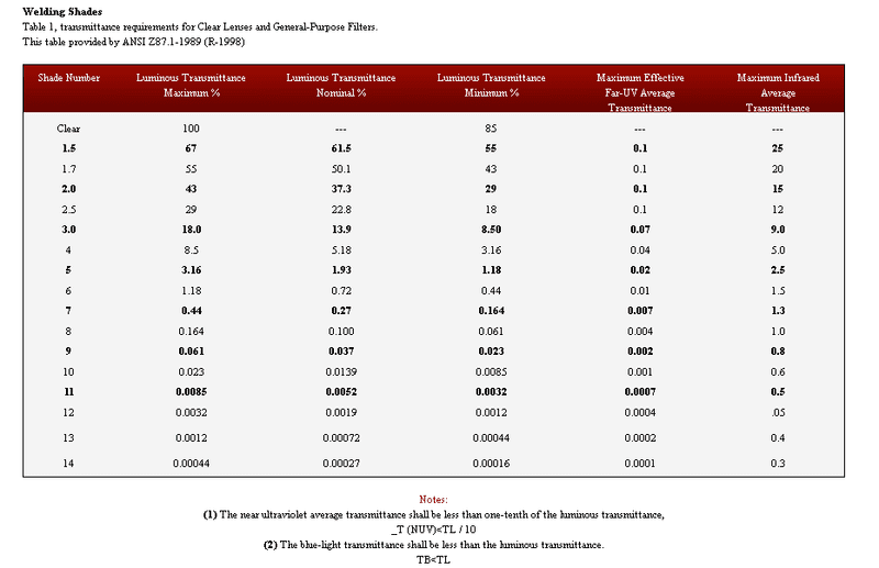

It's difficult finding what the "SHADE" numbers mean.
I found this on a photography referenced at a photography site.
http://www.x-celoptical.com/occupational_eyewear.php
It references an ANSI standard which ought to be credible
but i was unable to find the standard itself.
Anyhow to your question , check my arithmetic and logic here ?
If a #5 has nominal transmittance of 1.93 %
two of them would transmit 0.01932 = 0.000372 = 0.0372% just about a number nine . That's almost an add but not quite...
Taking square root of a #14 's nominal transmittance, 0.00027% = 0.0000027 , gives transmittance of 0.00164 = 0.164% which falls between nominal #7 and #8 (actually right on a #7's minimum).
That's another 'almost add' .
So i think they don't quite exactly add, but close enough for estimating.
For two #10's i calculate 0.0139%2 = 0.0001392 =1.93 X10-8 = 1.93X10-6% and that's what i plan to use. I know it's plenty dark because i tried it.
I also tried a #5 and #12 together for which i calculate 1.93% X 0.0019% = 0.0193 X 1.9X10-5 = 3.67X10-7 = 3.67X10-5% . I found that quite comfortable yesterday afternoon .
I found a single #12 , 1.9 X10-3% painful.
So I'm thinking i want transmittance less than 10-4%. That keeps me a decade away from pain.
A single #14 is 2.7 X 10-4 % , myself i'd want darker. EDIT this line has been edited see belowNote in the table how widely the maximum and minimum values bracket nominal .
Since in multiplication we add exponents i think you can add welding shade numbers for purposes of estimating. They seem almost logarithmic per that table.
Lastly , It's stressful converting units.
Attenuation is inverse of transmittance , so i'd want attenuation greater than 1/10-4% , > 1/10-6 , > 106
Maybe you'll find a diverse source to cross check me ?

jim hardy said:
@Blank_Stare
I found this on a photography site. It references an ANSI standard which ought to be credible
two of them would have transmittance of transmit 0.01932 = 0.000372 = 0.0372% just about a number nine . That's almost an add but not quite...
For two #10's i calculate 0.0139%2 = 0.0001392 =1.93 X10-8 = 1.93X10-6% and that's what i plan to use. I know it's dark because i tried it.
A single #14 is 2.7 X 10-4 % , myself i'd want darker.Note how widely the maximum and minimum values bracket nominal .
Attenuation is inverse of transmittance , so i'd want attenuation greater than 1/10-5% , > 1/10-7 , > 107
Believe me at my age i value what's left of my eyes.
old jim

jim hardy said:
@Blank_Stare
To a good approximation, the visible light follows e^(-n+1) where n is the shade number. As an example, shade n=4 would suggest e^(-3)=0.0498=4.98% transmission - the table says 5.18%. What adds up is "shadenumber-1", so 4+4 is as good as 7 because (4-1)+(4-1)=(7-1).
Converting the Sun to a full Moon like brightness needs a factor 400,000, about shade number 14.
This does not apply to infrared, where stacking more than one shade blocks much more than using a higher shade number.

Blank_Stare said:
"When stacking, does the effect translate to all wave lengths?"
Excellent question. The table above that's attributed to ANSI has a column for UV transmittance, look how small are all the numbers.
I know that welding shades protect against UV because I've got many a sunburn from arc welding with no shirt on.
I have to assume they also protect against IR because welding makes plenty of that , anything designed to protect eyes would have to. The IR column in the table is a little frightening though . Shades transmit IR a lot better than visible and UV.
Workers in hot environments, exposed to IR, developed lenticular opacities due to IR irradiance in the order of 80–400 mW/cm2 on a daily basis for 10–15 years.[9] Pitts and Cullen[10] showed that the threshold exposures for acute lenticular changes caused by IR-A were of the order of 5 kJ/cm2 for exposure durations of the order of an hour or longer and the threshold irradiances for damage were at least 4 W/cm2. The ICNIRP commission therefore recommended that to avoid the thermal injury of the cornea and the possible cataractogenesis, IR exposure (770 nm–3 µm) should be limited to 10 mW/cm2 for lengthy exposures (> 1000 seconds), and to 1.8 t–3/4 W/cm2 for shorter exposure durations.
source: https://www.ncbi.nlm.nih.gov/pmc/articles/PMC3116568/
So NIH suggests 0.01 watts per cm2.
Per Wikipedia , sunlight is about 1361 W/m2
https://en.wikipedia.org/wiki/Solar_constant
which is 0.136 watts /cm2 some 13X the 'safe' limit for lengthy exposure to IR .
Now the sun isn't all IR
but attenuation greater than 13.6X will attenuate the whole sun spectrum below that IR limit from NIH.
1/13.6 = 7.3% , so transmittance less than that should make the IR level safe .
Shades 4 or greater should give protection against IR.
Your eye will hurt from the visible with just a #10 . If your retina is comfortable with the visible i think your lens is safe from IR.
X-rays ? I don't know, will carry a shade in my pocket to next chest x-ray .
The more i look at that table the more i realize what should have been intuitive - welding shades protect against short wavelengths. See the two notes at bottom.
I'm no optics expert by any stretch - just i do always apply my basics to figure things out. I welcome corrections by anyone.
@mfb made a great post while i was typing.
old jim
