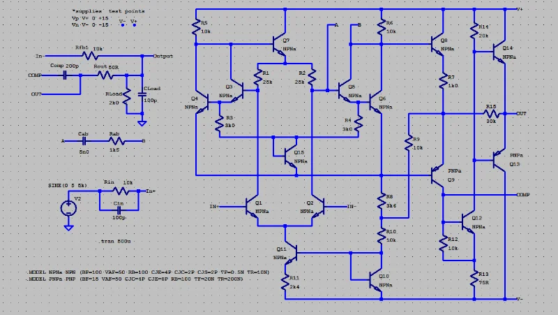

Most likely this can only be answered by an "old timer". I am making measurements on an uA709 op amp (metal can). I would like to calculate the frequency rolloff curves (I can measure them). I assume the compensation is via the miller effect. To do the calculations I would need to know the gain of the transistors and the effective resistance seen at the compensation terminals, not including the values I put there.
Anyone know those values?

I have the schematic but not a spice program. Will have to look into getting one. However, using the open loop curves of Fairchild and doing some backtracking I find:
With C1=10pf and R1=0, the breakpoint looks to be 10khz. That would give an equivalent resistance working with C1 of 15.9 k ohms.
With C1=100pf and R1=1.5k, the breakpoint looks to be 1khz. That also equates to an equivalent resistance of 15.9 K ohms; makes sense as the frequency changes by x10 as does the capacitance.
The crossover frequency of the R1C1 is about 1 Mhz, so that does not come into play until the 2nd breakpoints.
So, assuming gains of 100 for the internal stage I get an R value of 15.9 k ohms. I don't see how to arrive at that given the schematic, but I don't know how to analyze it in that detail. I am of course just guessing on the gains.
Here is an LTspice model for the uA/LM709. At the end it defines the transistors used as all having the same specifications.

Using method 1. I chose to have the operating point calculated. However, after choosing "run" the program says "This circuit does not contain a node other than node 0, gnd."
You need to comment out the *.subckt and *.ends to make the nodes and components in the model available on that schematic page. You can then connect it to external schematic by using the internal node names.
Attached is uA709.asc.txt which can be attached to a post because it is an ASCII text file. Save it, and rename it to uA709.asc and it will run under LTspice.
There is some problem with the file that causes an offset voltage and so a high input current. Maybe the substrate voltage? I will take another look when I have time.
Forget my previous post.
I have fixed a few bugs and got the uA709 / LM709 working as a 5kHz voltage follower. Attached are the .asc and .plt files you need to test it. You should be able to analyse the uA709 by modifying only the external circuit. Remember to remove the .txt extensions.
Here is the schematic of the .asc file, best viewed by in LTspice.
