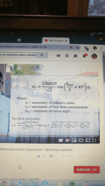

For a physics experiment I need to find the uncertainties and I am using the angle of minimum derivation formula:
1a4ee7cc8377d03e0e50298e6cae5debc6a747b3
The value of A=60° and one of the values of D is 29.7° which has a uncertainty of ±2 (I know it's a very high value)
How do I calculate the uncertainty for this?

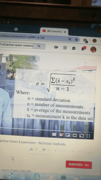

I found a video which included some formulas but I did not understand (attached photos)
Screenshot of a YouTube video frame showing the equation sigma_r = 1.00029/sqrt(2) times cos((theta_md)/2 + 45°) times sigma_l, with definitions of the variables and a derivation of the uncertainty formula.
Screenshot of a video frame showing the standard deviation formula: sigma equals the square root of the sum of (x bar minus xk) squared, divided by n minus 1, with definitions listed beneath.

When you write ## n_{\lambda}=f(D_{\lambda} ) ##, then ## \sigma_{n_{\lambda}}=(\frac{\partial{n_{\lambda}}}{\partial{D_{\lambda}}}) \sigma_{D_{\lambda}} ##. ## \\ ## Do you know how to take the derivative? (In this case, you really only have one variable ## D_{\lambda} ##, so the partial derivative signs aren't necessary). ## \\ ## In the page that you show in the OP on the left, I think they are ignoring any uncertainties in the apex angle.

If the value of ## A=60^{\circ} ##, I think that should be ## 30^{\circ} ## rather than ## 45^{\circ} ## inside the cosine function.## \\ ## (I think they may have used ## A=90^{\circ} ##, and that would explain the factot of ## \sqrt{2} ## that they get in the denominator, i.e. ## \sin(\frac{90^{\circ}}{2})=\frac{\sqrt{2}}{2} ## ).

I can show you the calculus. Let ## D_{\lambda}=x ##. We will treat ## A ## as a constant. The formula you have for ## n_{\lambda} ## is then ## n_{\lambda}=\frac{\sin(\frac{x}{2}+\frac{A}{2} )}{\sin(\frac{A}{2})} ##. ## \\ ## ## (\frac{dn_{\lambda}}{dx})=(\frac{1}{\sin(\frac{A}{2})})(\frac{1}{2})( \cos(\frac{x}{2}+\frac{A}{2})) ##. ## \\ ## [And ## \sigma_r=(\frac{dn_{\lambda}}{dx})(\sigma_L) ##].## \\ ## Can you follow the chain rule that I used to get the ## (\frac{1}{2} ) ##, (middle term), because it is ## \sin(\frac{x}{2}+\frac{A}{2} ) ##, (with a 2 below the ## x ##) ? ## \\ ## I'll show you the chain rule here: If ## f(x)=\sin(x) ##, then ## f'(x)=\cos(x) ##, ## \\ ## but if ## f(x)=\sin(\frac{x}{2}+c) ##, then ## f'(x)=(\frac{df(u)}{du})(\frac{du}{dx} ) ##, where in this case ## u=\frac{x}{2}+c ##. ## \\ ## Meanwhile the factor ## \sin(\frac{A}{2}) ## in the denominator is simply a constant factor: i.e. ## \frac{d( Cf(x))}{dx}= C \frac{d f(x)}{dx} ##. ## \\ ## The calculus is a little easier than it first looks. Don't be afraid to study it=I do think you should be able to follow the derivation.:smile: ## \\ ## Edit: See also post 6 above again=I added some detail.

The uncertainty is ## \sigma_r ##. They might do well to call it ## \Delta n ##, but they are using statistical type of language, where ## \sigma ## is the letter they use for standard deviation. And yes, what you have is correct. The uncertainty ## \Delta n=\sigma_r=(\frac{dn}{dx})\sigma_L=(\frac{dn}{dx}) \Delta_{\theta_L} ##. ## \\ ## One additional note: This one is a little tricky, because when you put in ## \Delta \theta_L= \sigma_L ## i this formula, you need to convert it to radians, i.e. express ## \Delta \theta_L ## in radians. The result is ## \Delta \theta_L=2 (\frac{\pi}{180} ) ##.Everywhere else you can use degrees, and it doesn't matter, but here you need to have ## \Delta \theta_L ## in radians. ## \\ ## The reason for this is the derivative of the ## \sin(x) ## is equal to the ## \cos(x) ## only when ## x ## is measured in radians. Otherwise there is an additional factor. (This is kind of an advanced topic. I'll try to explain:) To start this explanation, they are basically writing ## dn=\Delta n=(\frac{dn}{d \theta_L}) \, d \theta_L=(\frac{dn}{d \theta_L}) \, \Delta \theta_L ##. The derivative gives you the cosine only if it is measured in radians. The derivative derivation assumes ## \frac{\sin(\Delta x)}{\Delta x }=1 ## for small ## \Delta x ##, but that is only the case of ## \Delta x ## is measured in radians. If ## \Delta x ## is measured in degrees, then in taking the derivative, the factor that appears of ## \frac{\sin(\Delta x)}{\Delta x} ## for small ##\Delta x ## will give a factor of ## \frac{\pi}{180} ## instead of a factor of one.
