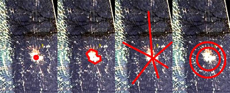

Are there any conditions under which glass cracks spontaneously?
Just now, my mother's rear windshield cracked spontaneously.
The story according to her:
Slowly approaching a stop sign. No busy traffic. No trees/animals in sight. Few people. Suddenly, the rear windshield cracked with a loud boom with no evidence as to what caused it. A police officer happened to be directing traffic and saw it occur. The officer did nothing about it since there was no indications as to what caused it.
This is very strange! I don't believe that this could have just happened without a something hitting the window. I suspect it happened so quickly no one saw it. But, apparently, there were no cars, and few people, so they believe that the object impacting the glass scenario is not possible.
My question now is: is it possible that the glass cracked spontaneously? For reference, the temperature outside was 34 degrees Fahrenheit, the temperature inside about 70 degrees Fahrenheit.
Thanks for any replies/insight!
In this picture above, you can see the indications that some impact occurred.

Given that the outside temperature was about 1°C and the inside temperature was near 21°C, I would make the trivial guess that it was a drop of water. But can it be spontaneous when temperature difference is 20°C? That's a question. Moreover, a single drop of water will create cracks that originate from a point and spread, but not smash the glass like that. I can surely see some cracks traveling from the impact, but I doubt whether a drop can smash the whole glass.
That would be my guess as well. Given how many millions of cars are on the road in similar temperature conditions without spontaneous fracture, some outside impact seems likely.
Search the back of the car -- unless it was a large ice ball from a passing airliner, there may be a rock or branch or other evidence of an impact.

It's also possible by the way, that there were independent events.
The first impact may have occurred at any time in the past, creating fractures in the glass that went unnoticed for days, weeks, years.
Then something (maybe not even a second impact) caused the glass to collapse.

It looks like the cause was as the others have said. Edge damage (circled) and particularly the impact mark (arrow) very likely initiated stress cracking which went unnoticed until the final, catastrophic failure.
Once compromised, normal stressors such as thermal cycling of the defroster wire grid will contribute to final failure.

Yes, it could have been a manufacturing flaw. Tempered glass contains a lot of internal stresses by its very nature. That's what makes it tempered glass. (One could reduce the internal stresses by annealing it, or simply not tempering it, but then it wouldn't be tempered glass.) The tricky bit is make sure the internal stresses are distributed roughly evenly throughout the glass, and such that the internal stresses are within acceptable thresholds at every location. I'm guessing that's easier said than done.
On the other hand, stresses might also come from outside the manufacturing process. If the car was ever in a fender-bender -- even a mild one -- the auto shop will likely pound out or replace the dented fender, but would never replace the rear window if there were no visible signs of damage in the rear window. The new, extra, uneven stresses [edit: might*] remain in the window though. The OP might know more about the car's history, of course, unless the OP's mother obtained the car second-hand; in which case it's anybody's guess.
*[depends on the nature of the fender-bender and the rear window's mounting, etc.]
If it were a flaw, could it fail in a way that looks like the closeup in post #13?
I mean, that really looks like an impact.

I agree. It does visually appear like an impact. The pattern seems to radiate from a specific point.
I guess what I'm saying is that, particularly given the testimony by the OP's mother,
  • We don't really know how long before shattering that the impact spot was there,
  • If some sort of impact did coincide with the shattering (maybe a small, hard pebble or piece of porcelain thrown out from the street by a nearby truck tire), the impact might not have been the only stress factor involved, and
  • maybe there wasn't an impact, and that spot just happened to be the point on the glass that was most brittle. Even if the shattering happens spontaneously, it has to start from somewhere.
Or maybe it was from an small caliber firearm or air rifle (i.e., BB gun). It's kind of difficult to tell from the picture. It seems kind of odd though that somebody would be brazen enough to shoot at traffic with a police officer right there directing traffic. So let's not jump to conclusions.

I think that a spontaneous shatter can be ruled out. I strongly suspect that the only way to get
  1. a hole
  2. a gradient that correlates amount of damage with distance from centre,
  3. radiating fractures, and finally
  4. concentric fractures
is from an impact of sufficient force to push the glass inward.
Frankly, I think a small rock is highly unlikely too.
Something hit it hard/fast enough to make a hole and deform the glass. Look at the larger concentric break (#4).
  1. a hole

I think that the picture in the OP is at least not inconsistent with any of these. I think it likely that the damage may have been caused by a hard piece of debris on the road getting kicked up by a tire and hitting the windshield. I also wouldn't rule out that the original fault point happened in the past, and the additional stress on the window passing over a bump or something was "the straw that broke the camel's back," causing the window to shatter.
@rugerts, You mentioned that there was a police officer nearby directing traffic. Why was the officer directing traffic? Was it because of a recent car accident (causing lots of debris in the road), or maybe there was some temporary construction going on in the road?
