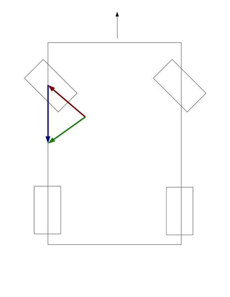

kk thank you all for your answers. I had another question. I was reading up the chapter. It said when a car moves in a circular way around a bend(With constant ω), the centripetal force is provided by friction. I cannot grasp fully this notion. How does the friction direct inwards toward the centre, shouldn't it just act opposite to the engines force at all times?
Because of its inertia, the car just wants to move in a straight line. But if you turn the wheels, then in order for this straight line motion to continue, the tires have to slide (relative to the road). Friction prevents this sliding from happening, and redirects the motion of the car to be in the new direction in which the tires are oriented. If you drive in a circle, this friction (which prevents the tires from slipping) will always point towards the centre of that circle.

I still don't understand how the friction points toward the centre. look at this rough sketch i made
http://tinypic.com/view.php?pic=24np9o5&s=6
the red arrow is the force of the car and the blue arrow is the same force, after turning. Now in both these cases the friction is the brown(backward) arrow, which is the same again for both cases, so how are these frictional force acting towards the centre, they are acting at a tangent, like the engine force.

The role of friction in the motion of a car is more complicated than for a box that you push along a horizontal surface. For the box, you're trying to make the box *slide* forwards along the surface. As a result, friction with the surface opposes this sliding, and hence is directed rearwards.
In contrast, a car doesn't slide across the road, it rolls. For a car, friction with the road is not rearwards and it does *not* impede the motion of the car. On the contrary, friction with the road is what *allows* this motion to happen. The tire grips the road, pushing backwards on it as it rotates. The road, in turn, pushes forwards on the car, propelling it forwards. I don't have time to explain this further, so Google "Rolling Without Slipping" for more details. So there is a *forwards* frictional force (RED in the diagram below) that is parallel to the tires. The diagram below depicts a (transparent) car viewed from the top down, with its front tires rotated to the left. The car is moving forwards, but we've just turned the tires to the left. So, the tires want to slide *laterally* across the road surface, but there is a frictional force (BLUE) that prevents this sliding from happen. This is the friction that I was referring to in my previous post (the friction that fails to be present when you *skid* across an icy road)
The resultant (i.e. vector sum) of these two friction forces is the GREEN vector in the diagram. As you can see, its direction is appropriate for changing the direction of the car's motion to follow the turn.
