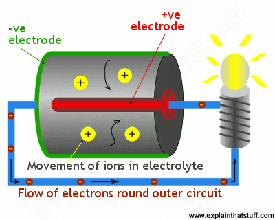

you mite also find this helpful concerning the electrolyte and the chemical reaction
from
http://www.explainthatstuff.com/batteries.html
Chemical reactions
Now back to our battery. The positive and negative electrodes are separated by the chemical electrolyte. It can be a liquid, but in an ordinary battery it is more likely to be a dry powder.
When you connect the battery to a lamp and switch on, chemical reactions start happening. One of the reactions generates positive ions (shown here as big yellow blobs) and electrons (smaller brown blobs) at the negative electrode. The positive ions flow into the electrolyte, while the electrons (smaller brown blobs) flow around the outside circuit (blue line) to the positive electrode and make the lamp light up on the way. There's a separate chemical reaction happening at the positive electrode, where incoming electrons recombine with ions taken out of the electrolyte, so completing the circuit.
The electrons and ions flow because of the chemical reactions happening inside the battery—usually two of them going on simultaneously. The exact reactions depend on the materials from which the electrodes and electrolyte are made. (Some examples are given further on in this article where we compare different types of batteries. If you want to know more about the reactions for a particular battery, enter the type of the battery you're interested in followed by the words "anode cathode reactions" in your favorite search engine.) Whatever chemical reactions take place, the general principle of electrons going around the outer circuit, and ions reacting with the electrolyte (moving into it or out of it), applies to all batteries. As a battery generates power, the chemicals inside it are gradually converted into different chemicals. Their ability to generate power dwindles, the battery's voltage slowly falls, and the battery eventually runs flat. In other words, if the battery cannot produce positive ions because the chemicals inside it have become depleted, it can't produce electrons for the outer circuit either.
Now you may be thinking: "Hang on, this doesn't make any sense! Why don't the electrons just take a short cut and hop straight from the negative electrode through the electrolyte to the positive electrode? It turns out that, because of the chemistry of the electrolyte, electrons can't flow through it in this simple way. In fact, so far as the electrons are concerned, the electrolyte is pretty much an insulator: a barrier they cannot cross. Their easiest path to the positive electrode is actually by flowing through the outer circuit.Dave

Wow thanks a ton, that cleared a lot of things up. I think I finally understand it. So a battery consists of 2 electrodes, an anode and a cathode. If you just connected two metals (with different electronegativities) through a wire WITHOUT an electrolyte nothing would happen because electrons don't want to just leave their stable state and cause a difference of positive and negative charge. However, if the two metals are exposed to an electrolyte, A chemical reaction occurs between the anode and cathode at the same time. The electrolyte oxidizes the anion therefore removing the electrons from it leaving behind a positive ion. This ion combines in solution with the electrolyte. When a wire is connected between the two terminals, the leftover electrons from the reaction now have a place to go and move towards the cathode since it has a stronger electronegativity than the anode. Once the electrons reach the cathode they combine with the ions out of the electrolyte and reduce them. Eventually a battery will die when the reaction between the anode and the electrolyte cannot happen due to the anode not having anymore electrons to give up. Is what I said correct?
