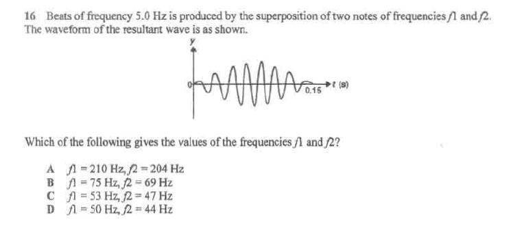

See attachment.
f1 - f2 = 5
What's there for me to interpret in the graph?

From the graph you can see 8 complete wavelengths. This occurs in an interval of 0.15s
therefore f=number of events(or wavelengths) / \Deltat .
R.
I counted 7.5 and taking a closer look the interval is 0.16.
f=8/(0.16)=50
What is this frequency? Is it the frequency of one of the sources? Or is it the resultant frequency?
By the way, the answer given is A
The f you calculated is the average of f1 and f2.
thereddevils said:
f1 - f2 = 5
The answer choices suggest a different value for f1 - f2.
so the answer should be C?
Based on your calculation of 50 Hz, yes. However, I recommend doing the following calculation over (can you spot the error?):
f=8/(0.16)=50
I think the author of the question is confused. They also stated the wrong beat frequency in the problem statement.
ok thanks all for helping.
