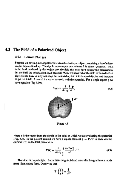

Upon reading about bound charges I stumbled on something I didn't quite understand. It is not a physical thing but purely a mathematical thing.
In the attached section my book wants to take the gradient:
∇'(1/r)
with respect to the source coordinates, r'. Now, can someone by inspection of the attached file tell me what these source coordinates represent. Are they they coordinates of a point inside some charge distribution with respect to a fixed point inside the distribution? Would that then mean that in vector notation:
r = R + r'
where R is the distance from P to the reference point inside the distribution?
And from all that can someone tell me how you would differentiate ∇'(1/r) with respect to
r' to get the answer in the bottom of the attached file? :)
thanks

… can someone by inspection of the attached file tell me what these source coordinates represent. Are they they coordinates of a point inside some charge distribution with respect to a fixed point inside the distribution?
no, (the diagram should say so, but doesn't :redface: …) they're the coordinates of the point marked "P" (which isn't the name of the point, it's the dipole moment density vector :rolleyes:) wrt a fixed origin (whose position doesn't matter)

I'm still a little confused on how r depends on r'. If R is the distance to the origin used for the coordinates r' isn't then, as I said:
r = R + r'
let's see …
in that integral, r is the outside point, and is fixed (a constant)
r is explained as the distance from r to r',
so r2 (the denominator) = (r - r')2
(the notation they're using is very misleading :redface:)
